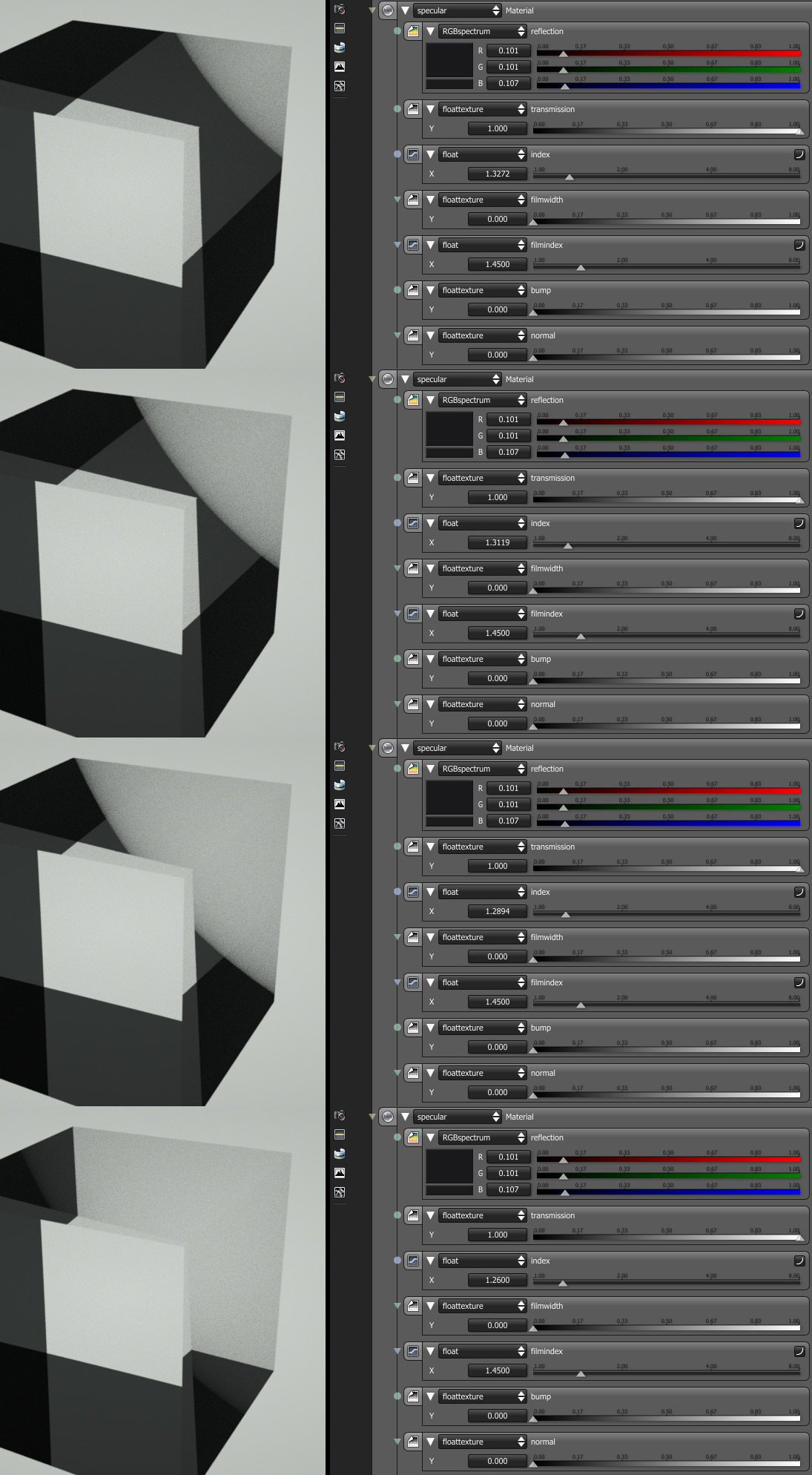

Have found another strange thing, maybe someone has report it.
Looks like a scaling issue, but an import in Modo shows me the correct size.
If I make a 1m cube and use a specular material, then i become a circle as transmission.
I can change the size of the circle with an other IOR value.
EDIT:
It comes at a maxdepth/speculardepth of 3
face
http://vimeo.com/user2509578
radiance
Posts: 7633
face wrote:Have found another strange thing, maybe someone has report it.
EDIT:
face
I think this is just normal internal reflection.
Does it also present with pathtracing at a propper maxdepth like something > 10 ?
Radiance

Posts: 3204
Location: Germany
Yes, it´s ever present. As long as the depth value is over 2...
Has seen the same effect with 1.022.
If the IOR is > 1.4 the angle to see it, is to sharp.
Maybe youre right and its a normal reflection.
face
