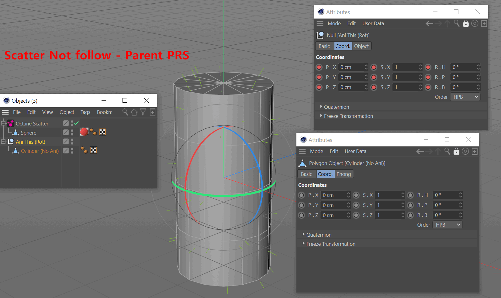

Scatter Object - Not follow, Parent Object Animation
