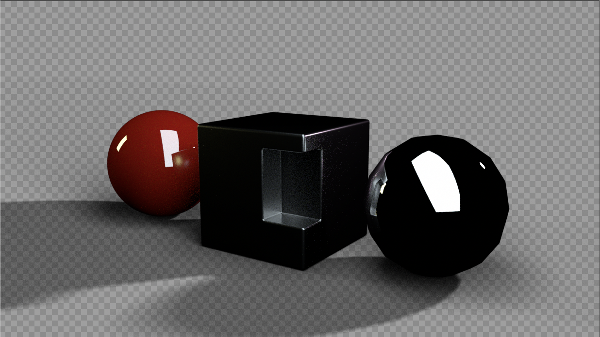

Hi, I am rendering the following:

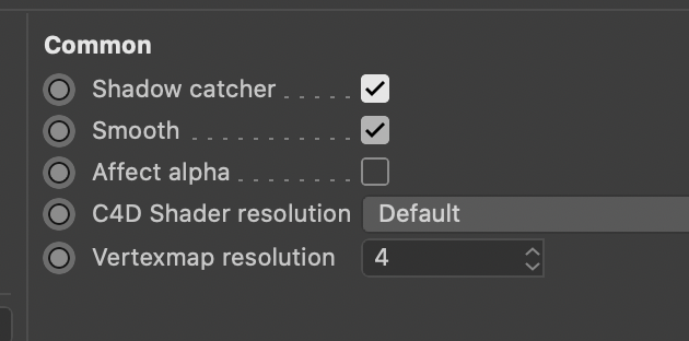

But I wanted to remove the floor keeping the shadows, so I've used the shadow catcher:

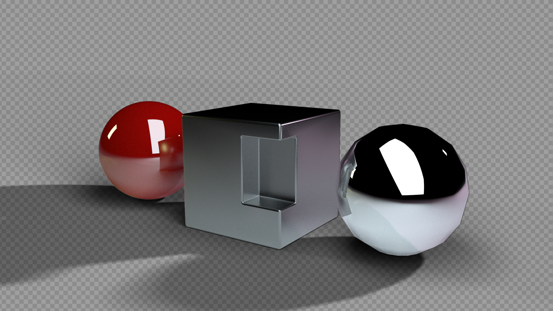

But this also removes all reference to the reflections and illuminations:
I wanted to achieve removing the floor but keeping everything else. Is something like this possible?:
