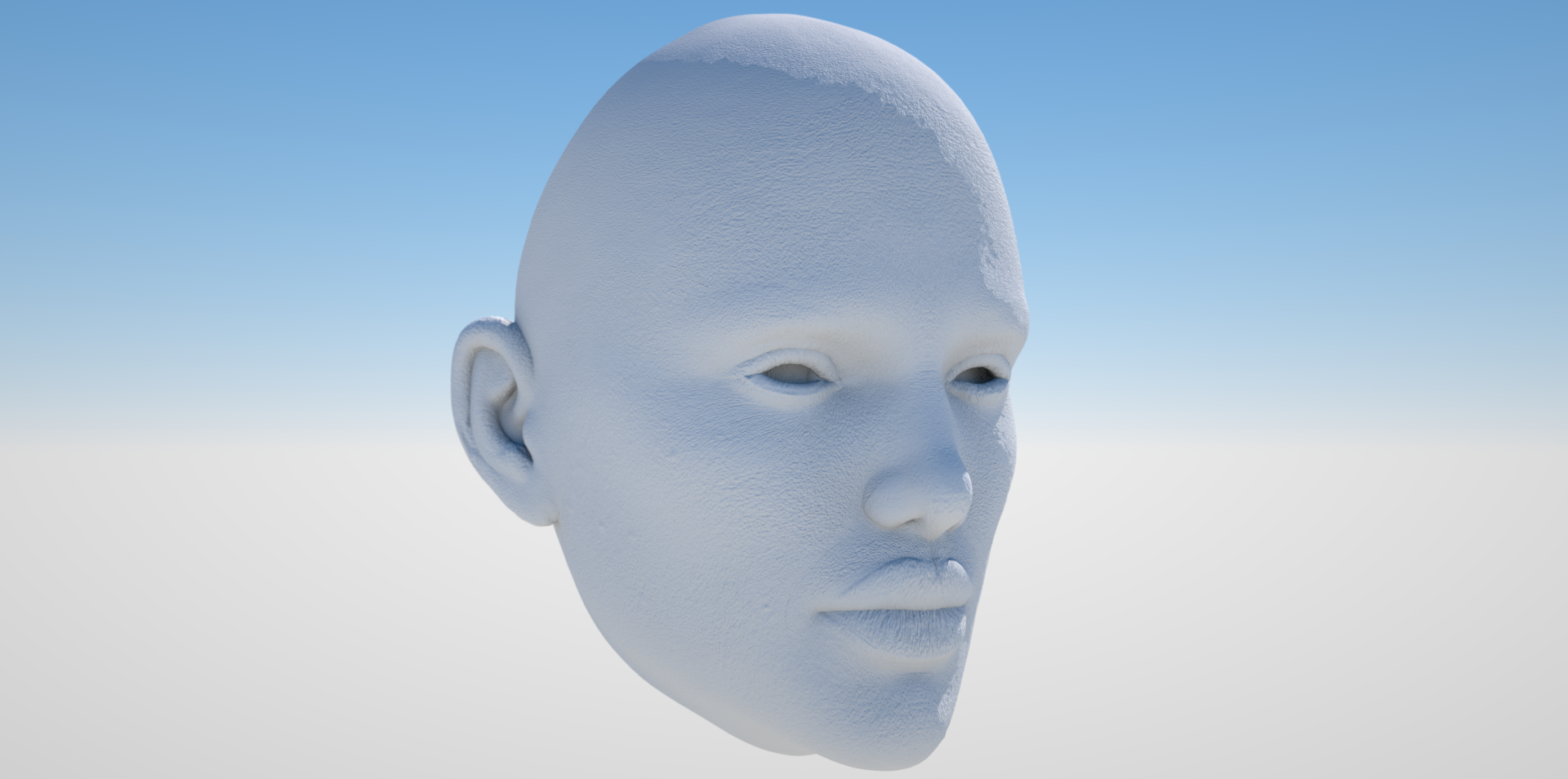

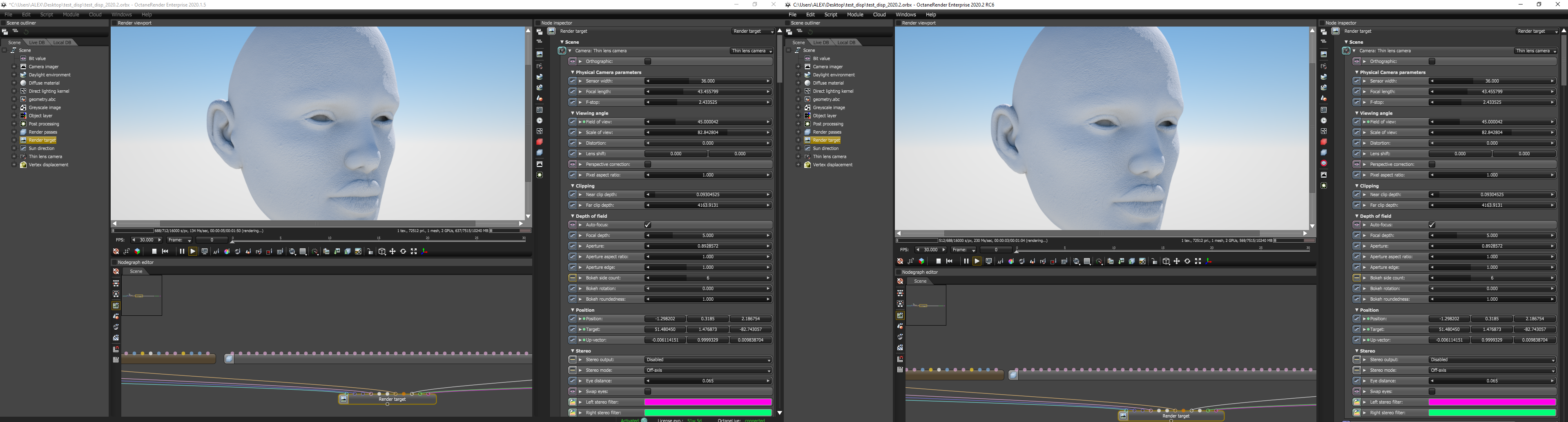

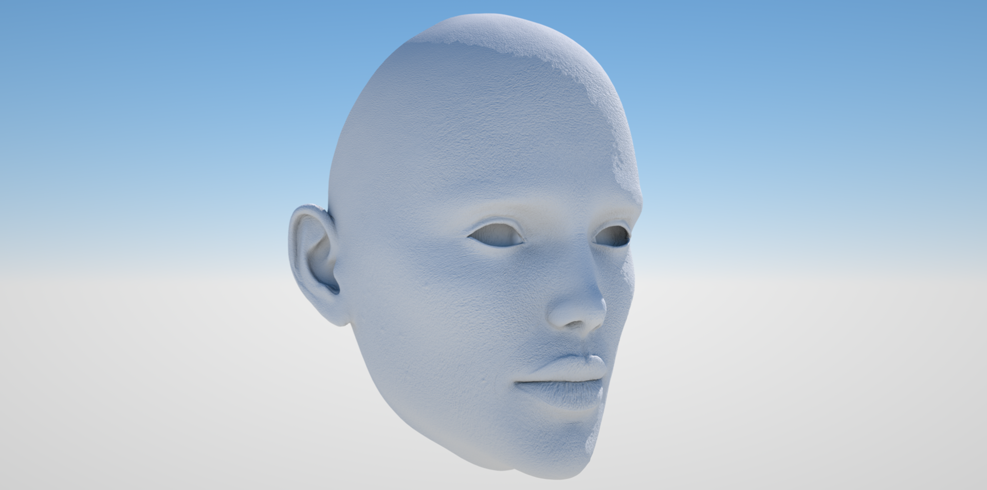

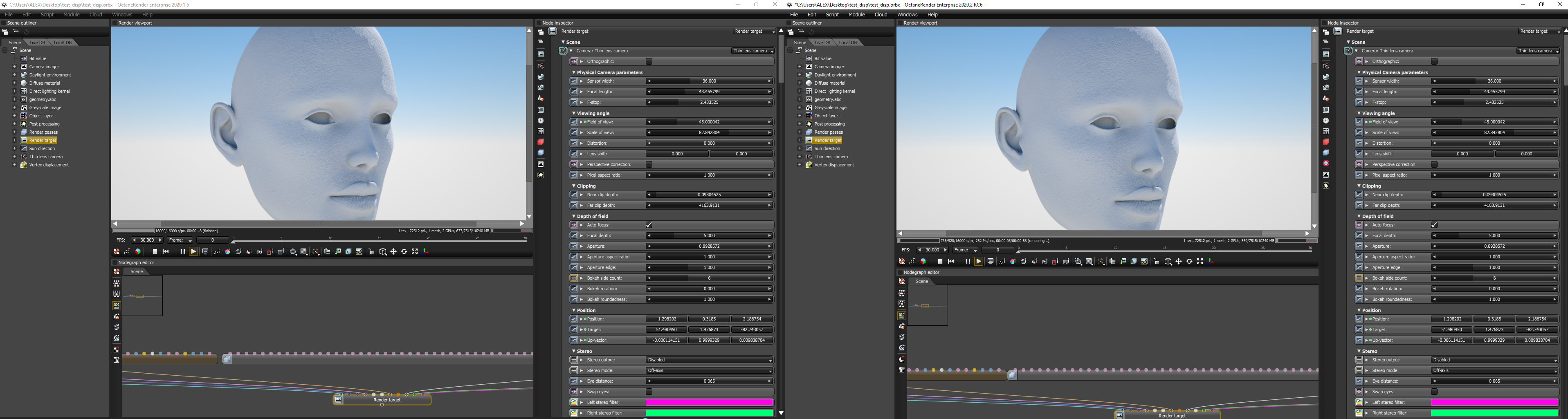

There seems to be a bug with displacement maps. I've attached screenshots. The one rendered in 2020.1.5 is correct. I also tested it in Standalone. Exported ORBX from both 2020.1.5 and 2020.2.0.1. ORBX from 2020.1.5 renders correctly while the one from 2020.2 is incorrect. I can send you the scene if needed.
Thanks.
Thanks.

There's indeed a problem with displacement maps and midlevel in houdini plugin 2020.2. Good to sse it's not just on my machine...galleon27 wrote: There seems to be a bug with displacement maps. I've attached screenshots. The one rendered in 2020.1.5 is correct. I also tested it in Standalone. Exported ORBX from both 2020.1.5 and 2020.2.0.1. ORBX from 2020.1.5 renders correctly while the one from 2020.2 is incorrect. I can send you the scene if needed.
Thanks.
I posted a bug report here :
viewtopic.php?f=103&t=76618
