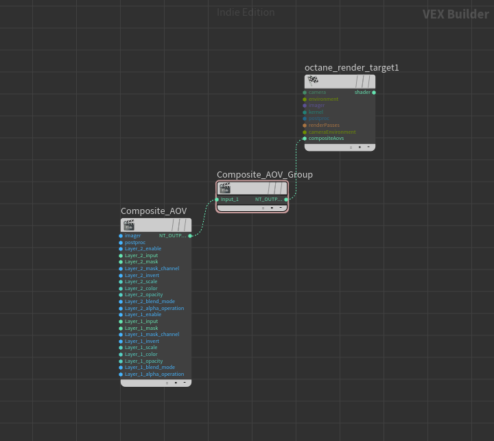

Is there a way to display the results of an AOV composite in the LiveViewer ?
In the AOV Composite node, when we create a new layer all the other layers are moved and renamed ex:
if I have 2 layers (1 and 2), when I create a new layer, it takes the name of layer 1, layer 1 is renamed 2, and layer 2 becomes 3.
Why is the new layer not layer 3?
It's a little confusing :?

All the additional AOVs should be available in the OpenGL IPR Window, but if you modify them after opening the window you need to use the option to refresh the passes menu.
About the layers workflow, I think that Standalone has this same behavior, designed to mimic how other layer-based compositing software adds the new layers always on top.
Happy Christmas!!!
You need to create a Composite AOV Group and plug that into compositeAovs in Render Target. Houdini lets you plug every output to any input but that doesn't really work in Octane. If you use Standalone, you'll notice that you cant plug a Composite AOV node directly into Render Target. It needs to go into Composite AOV Group first.
