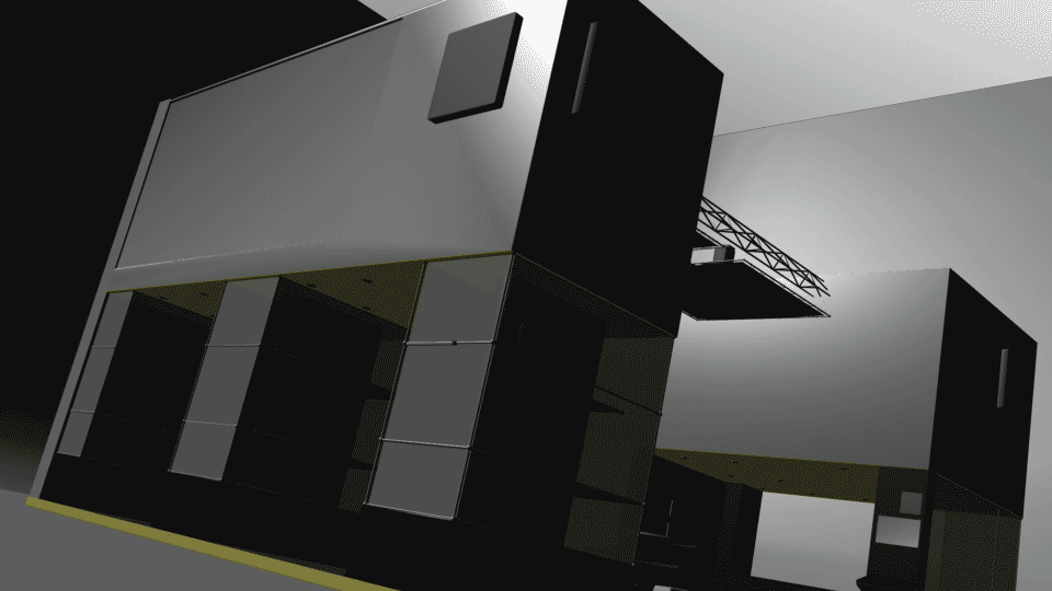

Hello. I have some other problem. When I export frame, camera "roll" when i look upward. Problem is visible only when i use this kind of frog perspective shot. here are examples:
http://img829.imageshack.us/g/camerarol ... ctane.png/
Am I doing something wrong?
Can you make a little Softimage scene and add it as zip?

Hm, i thought I has answer to this
Has you posted it also on an other thread?
The result from Octane and Softimage looks the same for me.
face
