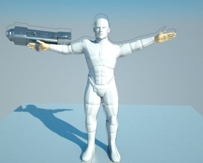

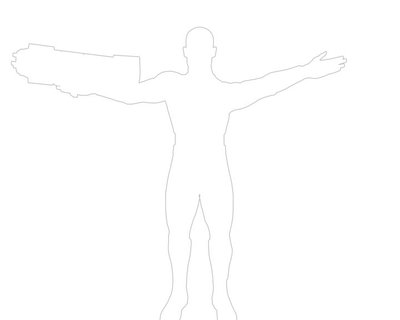

plugin v.122d..not same camera ,octane and softimage render?
i want to matte render with xsi..
xsi render
xsi render

Here is the result which may get you more help considering it takes the step of putting it together to see the problem away.

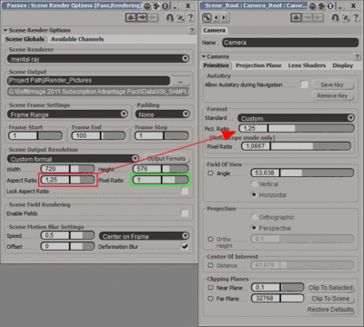

In Octane, a pixel is a square, so that a pixel ratio of 0.9 doesn´t work correct.
Use a pixel ratio of 1 in the render options and copy the aspect ratio from the render options to the camera picture ratio.

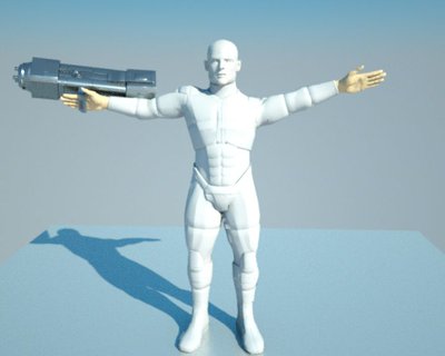

:D it's work, thank you face..

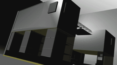

Hello. I have some other problem. When I export frame, camera "roll" when i look upward. Problem is visible only when i use this kind of frog perspective shot. here are examples:
http://img829.imageshack.us/g/camerarol ... ctane.png/
Am I doing something wrong?

Can you make a little Softimage scene and add it as zip?

The result from Octane and Softimage looks the same for me.
