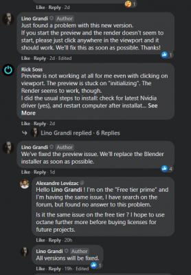

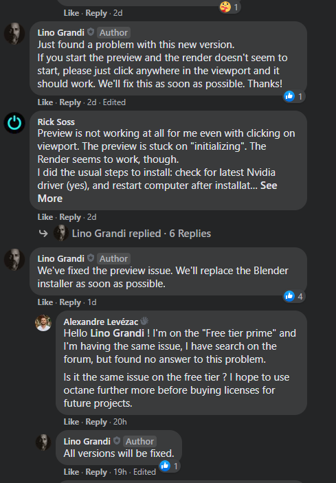

						working on a project in blender. denoiser not working when rendering. in the liveviewer the rendering wont even start.(waiting...)
blender also renders much slower than in other dcc.
i said it before and i will say it again, there is something severely wrong with blender plugin.
the support is investigating my reports.
