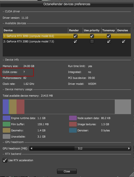

So I did some tests on different heavy scenes i´m working on.
First thing I noticed is enabling RTX nearly halfs the Ms/sec. I know it depends on the scene but before working with the 3090 enabling RTX brought a huge boost on most of my projects.
Secondly I´m a little dissapointed of the performance. Working with two RTX 2080 was almost the same speed as working with a 3090 and a 2080. Not sure if I should keep the card.
Just saw that "Number of Cuda-Cores" is not showing for the 3090:
Could this be a problem?
P.S.: Temps are OK!
System Specs
MB: Asus Pro WS X570-ACE
CPU: AMD Ryzen 3950x
GPU 1: NVIDIA RTX 3090FE
GPU 2: ASUS RTX 2080
RAM: Corsair Vengeance RGB pro 3200 4x16GB
OS: Win10 64bit
Cinema 4D R20
