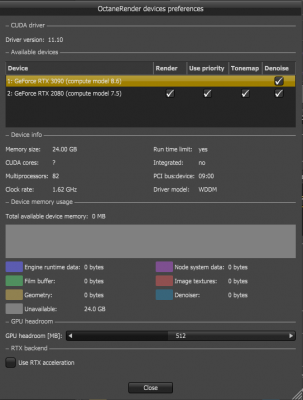

I just got my new rtx3090FE, plugged it in, started C4d and tried to config my settings. Unfortunatelly Octane does not recognize the card correctly. (see Attachment)
The log says: device 0: failed to find a CUDA binary matching compute model 8.6
So is it a problem with my card/setup or is the card just not supported yet?

Hmm. I have the latest studio driver (27.21.14.5730) and the card is in the correct pci-e slot. I deactivated RTX but still not working.
So it should run with 2020.1.5-R4 and the RTX 3090?

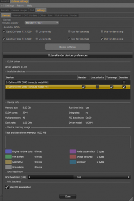

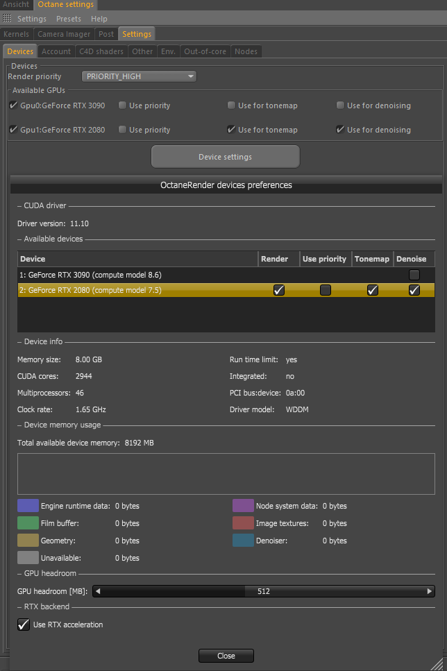

I can only check "Denoiser"
Seems I´m not the only one having this problem:
viewtopic.php?f=9&t=75865&p=393023&hili ... .6#p393023
The Octane-Benchmark is working fine...
