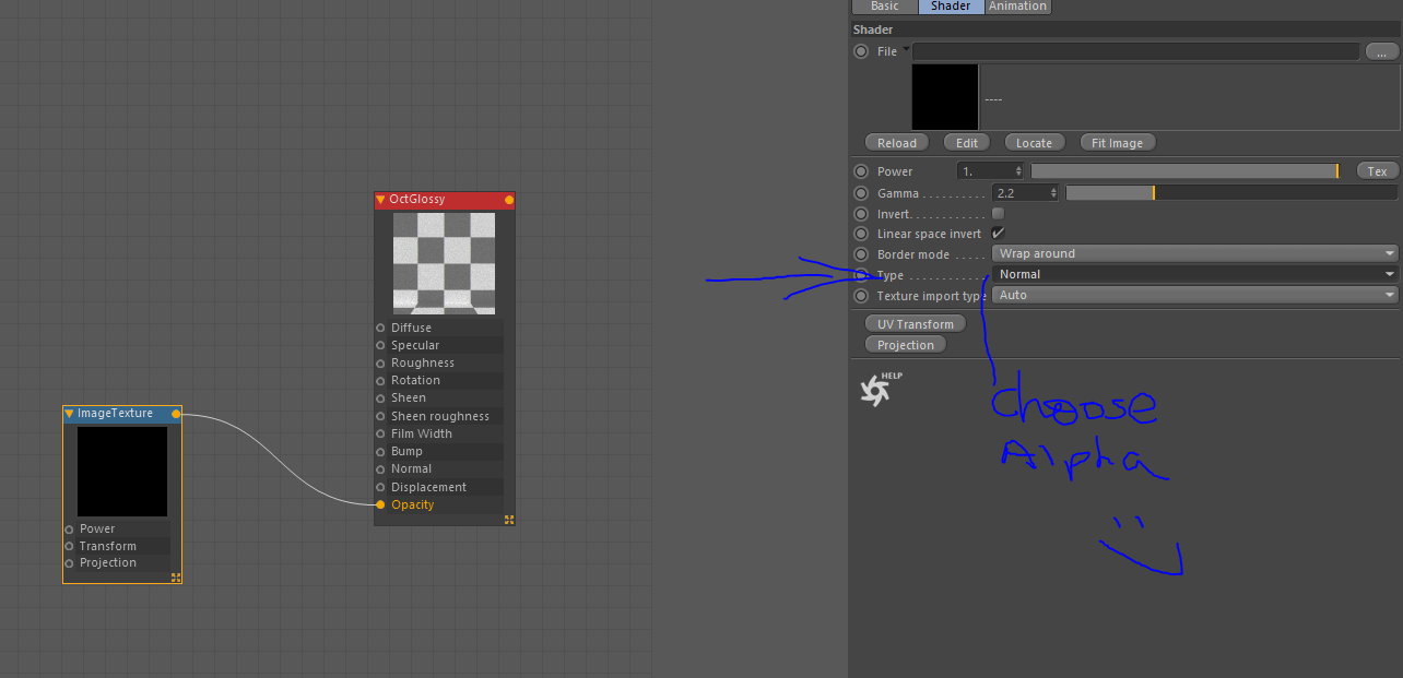

LanceClayton wrote:Thanks again Aoktar.
Where would you load an unique shaped alpha logo (mulit-coloured PNG perhaps) so that it sits nicely on the cylinder without tiling around.
Lance
When working with alpha in the Opacity input you can only use black/white and gradients in-between. When a png is used, like in aoktars example, the image texture type should be set to Normal. However, if a PSD is loaded with a separate alpha channel the Type must be set to Alpha. Border mode and Type is key in what you are trying to achieve. Make sure you are using ImageTexture node and not Bitmap, check the Node editor.

if your logo png does have an alpha channel, put it in an image texture node, connect it to the opacity and change the type to Alpha with in the image texture node
