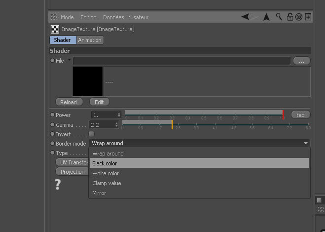

I'm trying to put a simple logo onto a bottle, and I obviously don't want it repeated. I've disabled Tiling in the texture tag options, but Octane continues tiling it. Is there any way for me to disable it? I searched online and found a 2013 forum post that said Octane doesn't support this? Is that still the case? It seems completely ridiculous that Octane wouldn't be able to handle this simple task.

try there
pxlntwrk.net

pxlntwrk wrote:Hi,
try there
Much appreciated man!
