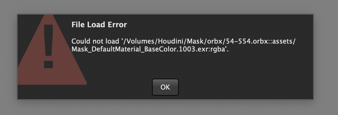

Not sure if it is a clue, but the standalone renderer is also throwing these erroneous messages when loading the orbx files I manage to export. These textures are not missing and they are properly rendered by Standalone despite this warning:

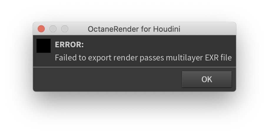

It also might be worth noting that the reason I am attempting to use Standalone in the first place is because there is a different bug happening in Houdini (maybe it is related?). After rendering about 10-20 frames of animation (doesn't matter which 10-20), the render begins to fail with this dialogue after each frame:

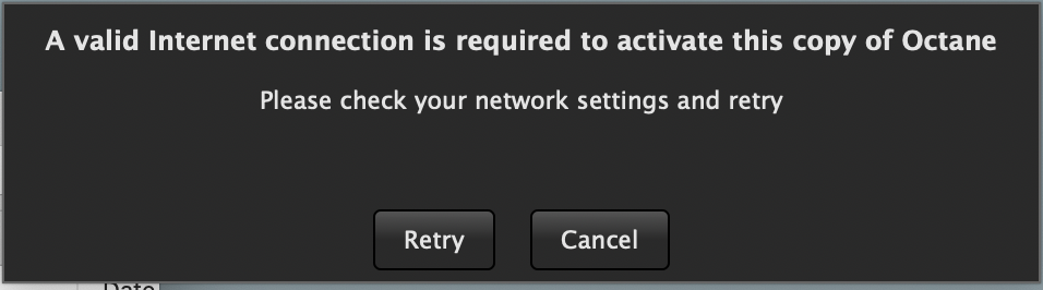

Sometimes it also then tells me I have no internet connection (I do and it is rock solid) or some other incorrect info about my license:

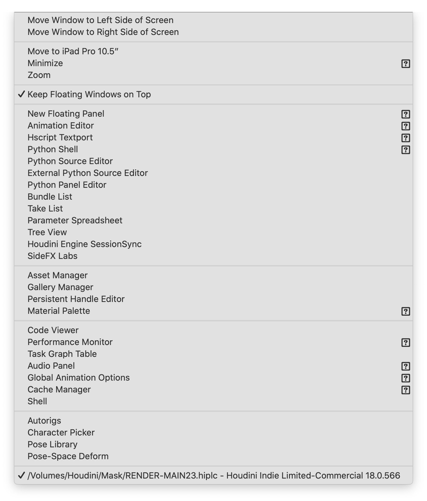

At this point, very strange things start to happen with Houdini and I have to restart (if it hasn't already crashed). For instance, all of the keyboard shortcuts in the app menus are replaced with the missing-character icon:
