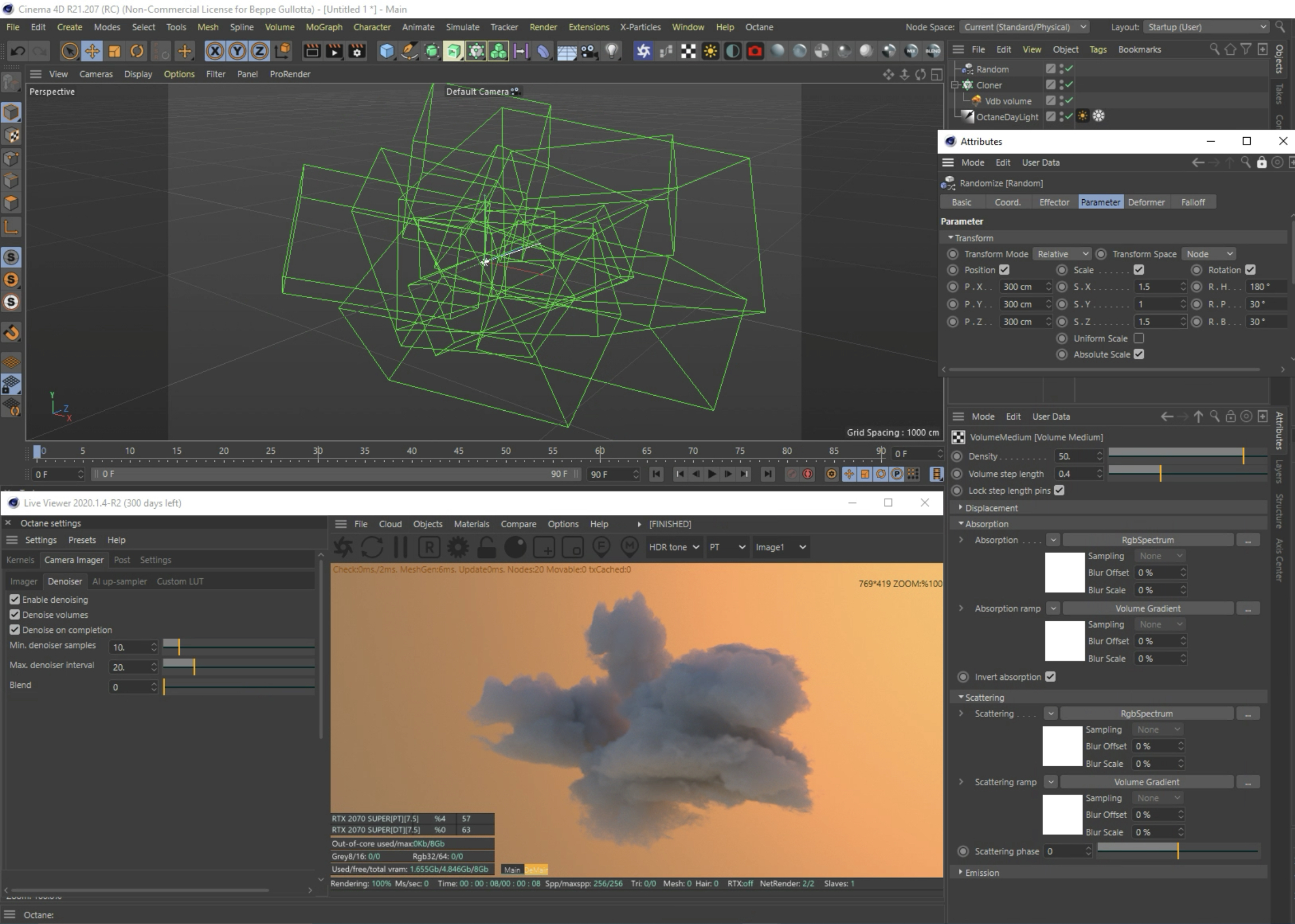

Posts: 10606
I have just tried to overlap a cloned vdb cloud with random position/scale/rotation, and everything seems to work as expected here in 2020.1.4, and it is also very fast to clean up:
Do you mind to share with me an example scene with assets that shows the issue?
