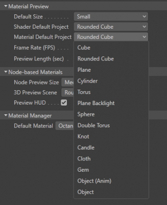

Another little issue is that Octane materials have always preview type as sphere and they don't use material preview type from C4D preferences.

SSmolak wrote: Another little issue is that Octane materials have always preview type as sphere and they don't use material preview type from C4D preferences.
Not an R23 issue, even not an issue. We don't have another type of preview type.
I mean this :

@smolak,
I talk about it, Octane doesn't have another types of preview balls. Just sphere+plane
