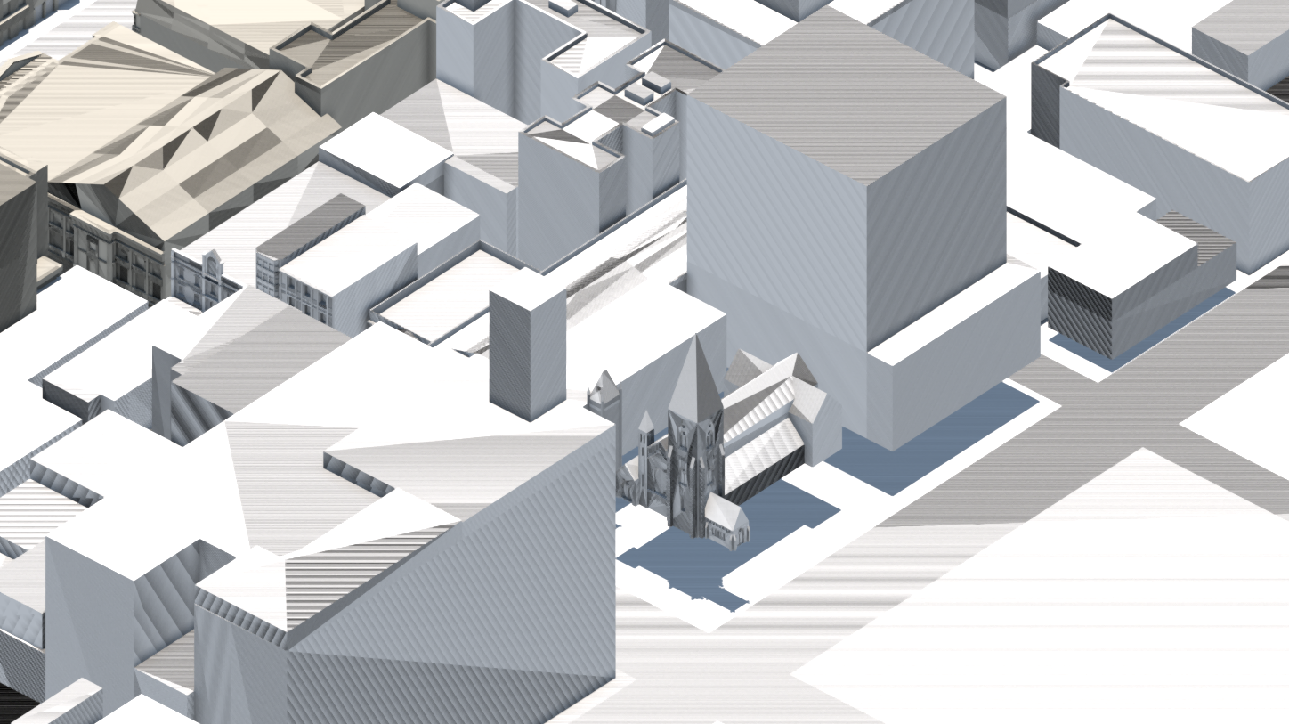

2. Glitching Image
-After the viewport is open (In Isometric view), the surface of the rendered models are glitched! never happened in rhino 5 by now in 6.
check attachment for reference images

the surfaces looks like a z-buffer issue... arethere coplanar / double surfaces in your model? Get rid of them (recommended) or try to change the ray-epsilon value (kernel settings) and see if this makes any difference.
Are you using the same units ?
Is the 3d model very far apart from 0/0/0 ?
If so try to move it to the world origin (0/0/0) and see if this changes something
Andreas

As Andreas said, this looks like a scaling issue. Make sure the origin of the scene is in the middle of your geometry, and that you have the scene units set correctly. Then adjust the Ray Epsilon. For a city scene like this, you would need a large Ray Epsilon than normal.

Adjusting the ray Epsilon does the trick (when there is no double surfaces in my model and the 0/0/0 is in the middle of the model)
