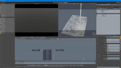

I'm trying this but without success.
I'm importing a phoenixfd animation. I see it well in modo but no way to render it in octane...
What I do wrong?
In Modo it works...
In Modo it works...
Can you PM me the .LXO and the .ABC file please?spigolo wrote:What I do wrong?
In Modo it works...
Paul
I have sent the file and scene.
Hi
I downloaded your file. Forgive me if I do not understand how you have setup your scene, however the KITCHEN.ABC file does not appear to be rendering in the Modo renderer. It's the PhoenixFDLiquid001 that renders, which is not an ABC file. I loaded KITCHEN.ABC into Octane Standalone, and it did not seem to render there either.
Paul
Paul
