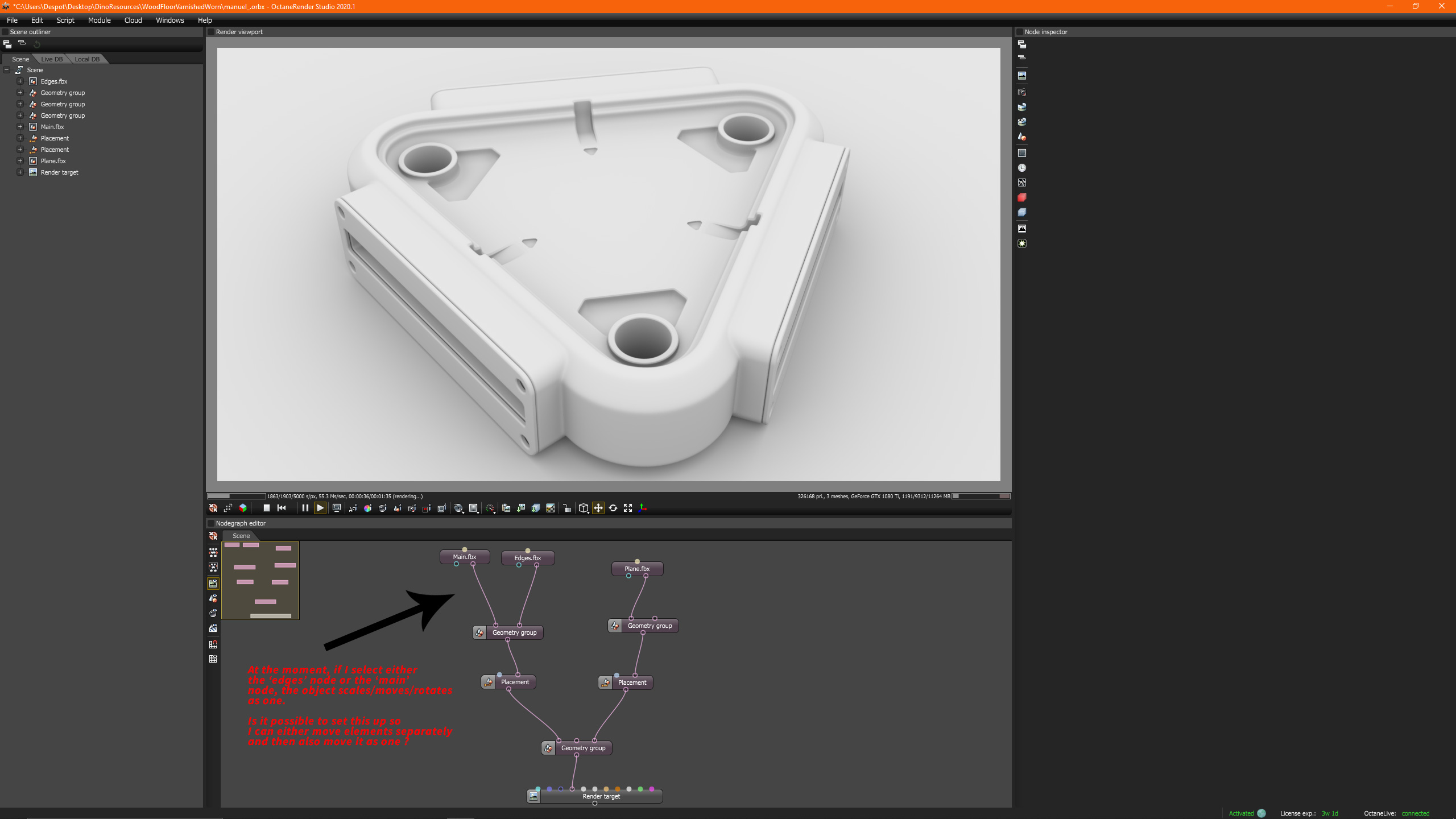

I know how to setup geometry in Standalone using geometry group/placement nodes etc - but I'm having trouble transforming/moving multiple groups simultaneously.
What I want to do is import an object that is comprised of multiple parts and either move it as a whole or move the separate elements individually.
Can somebody tell me what I'm doing wrong and point me in the right direction please.
Please see attached screenshot.
If i import from C4D as an ORBX, I have the same issue, I can move separate pieces of geo, but I cannot select multiple pieces and move them...

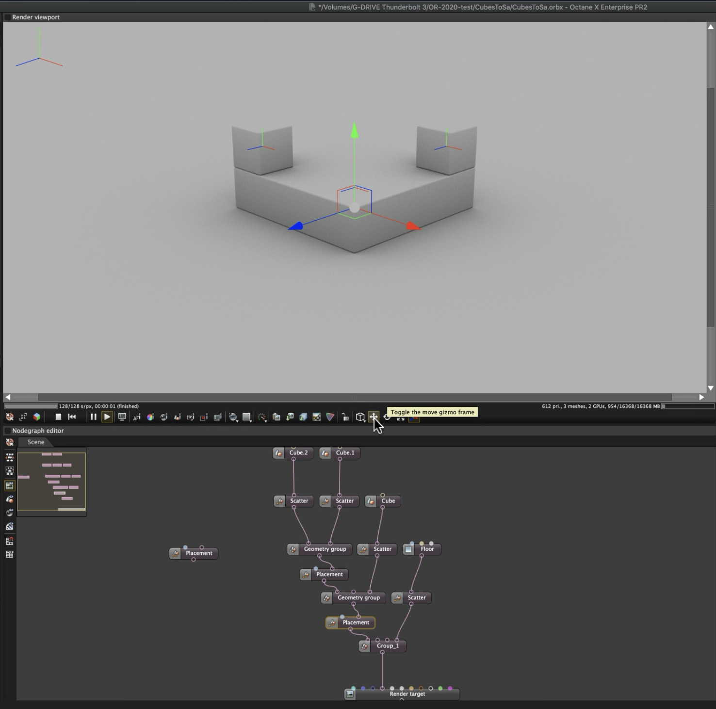

it should depend from the pivot of the objects, it is not visible in your screenshot, so it seems outside of the view.
Just tried with a couple of cubes, and everything works as expected:
CubesToSa.orbx.zip
(13.09 KiB) Downloaded 154 times
