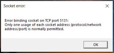

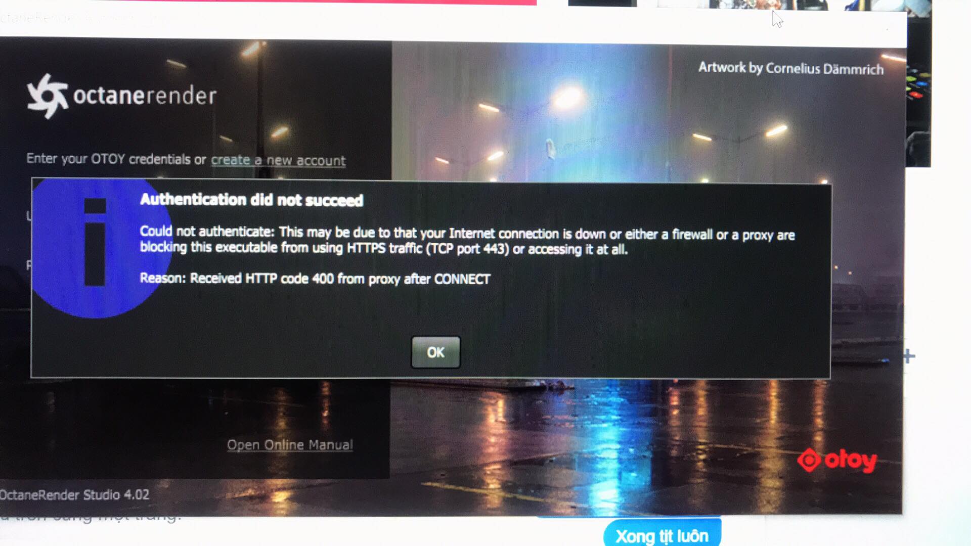

Hello everyone. I can not open Octane Server Studio and VR. Before buying the license, i have already instaled Octane 4.0 Demo version and every was working fine on my laptop. After instalation purchared versions, there were some errors appeared like "TCP Port 5130"; "TCP Port 5131" and "Authentication did not succeed from using TCP Port 443"
Does anyone have the same issues, and how to fix that? I don't want to waste my money :(

Make sure that there's no process of OctaneServer running (it might be, even if there's icon in the notification field [lower right], especially if Octane server crashed etc) in the Task Manager, if there is, kill it.
If that doesn't work, you can open PowerShell and run
Code: Select all
Get-Process -Id (Get-NetTCPConnection -LocalPort 5130).OwningProcess
or
Code: Select all
Get-Process -Id (Get-NetTCPConnection -LocalPort 5131).OwningProcess
to see what process is using those ports.
As for the last image, make sure that if you're using a proxy that those settings are correct, or disable/not set if your not using a proxy.
Also make sure that Defender, or any other Firewall isn't blocking Octane.

I'm getting the same error as well and when I run the script above it shows that I'm currently running an Octane Server. How do I either disable it or switch to the correct server?

I see the that Octane Server is running in the PowerShell. How do I deactivate it to run the Octane Server for Blender?
Handles NPM(K) PM(K) WS(K) CPU(s) Id SI ProcessName
167 14 141576 43216 0.44 10728 1 OctaneServer
