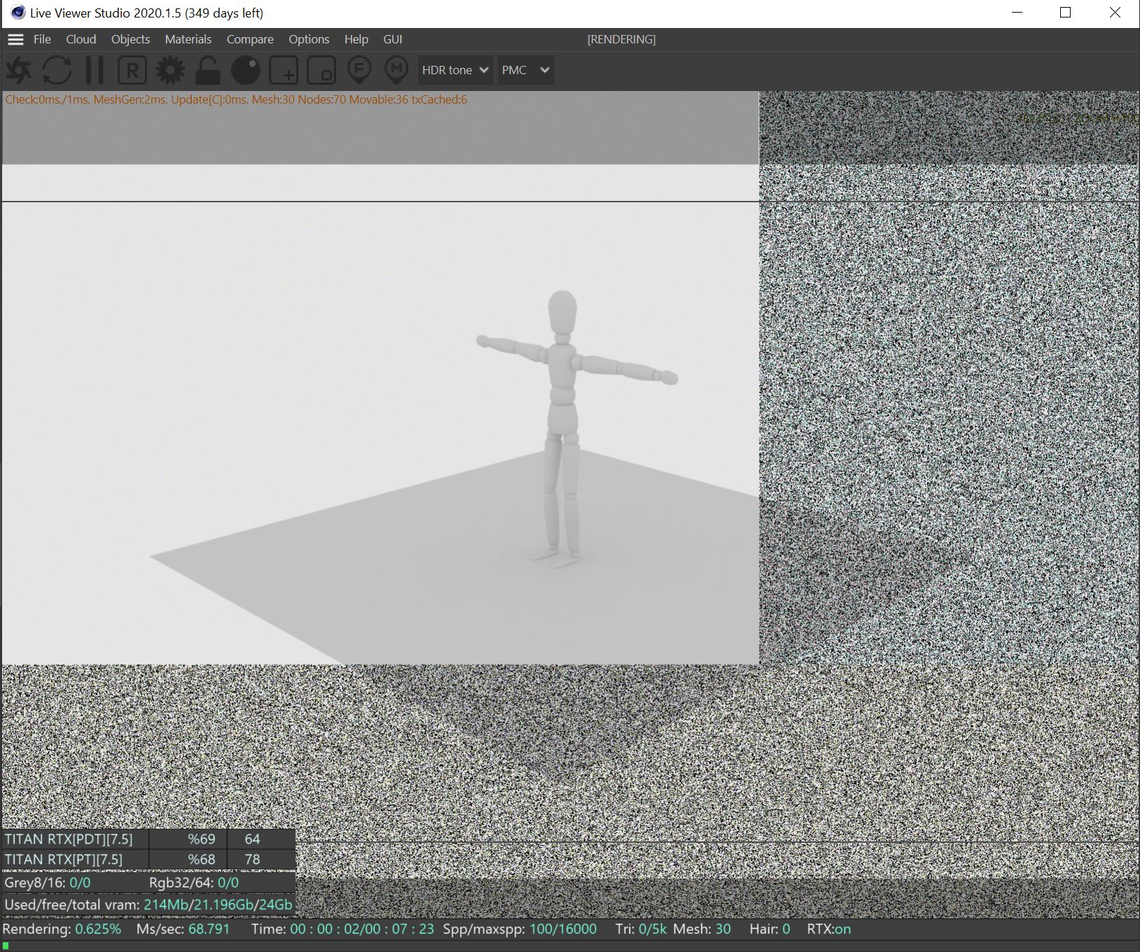

Also getting the broken render like mtb_mike showed above in Live Viewer. Same right side and bottom artifacts. Works fine when rendering to picture viewer.
I have the latest 452.06 Nvidia Studio Driver and the latest C4D S22.123 installed.
Went back to previous version 2020.1.4.
UPDATE: I have to stretch the LV window really big horizontally and vertically to have the artifacts fade away from my render. Never happened in previous versions.[/b][/b]

dynaraton wrote:Also getting the broken render like mtb_mike showed above in Live Viewer. Same right side and bottom artifacts. Works fine when rendering to picture viewer.
What's screen resolution? Using a desktop scaling?
Under my Windows 10 display settings it shows:
Scaling - 150% (recommended)
Display Resolution - 3840 x 2160 (recommended)
I am back on 2020.1.4 and everything is fine as was in previous versions. I didn't make any changes to my scaling or resolution.
Thanks for the quick response.
Asus Prime Deluxe II : Intel i9-10900 X : 128GB G.Skill 3600 MHz DDR4 RAM : (1) Nvidia RTX Pro 4500 Blackwell, (1) Nvidia RTX TITAN: Win11 Pro : Latest Cinema4D
Posts: 16068
Location: Türkiye
@dynaration, it's probably about using %150 scaling. This version has canvas scaling addon as a difference against previous version. Try %100 for feedback.
