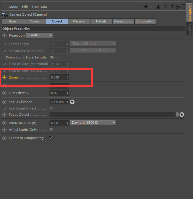

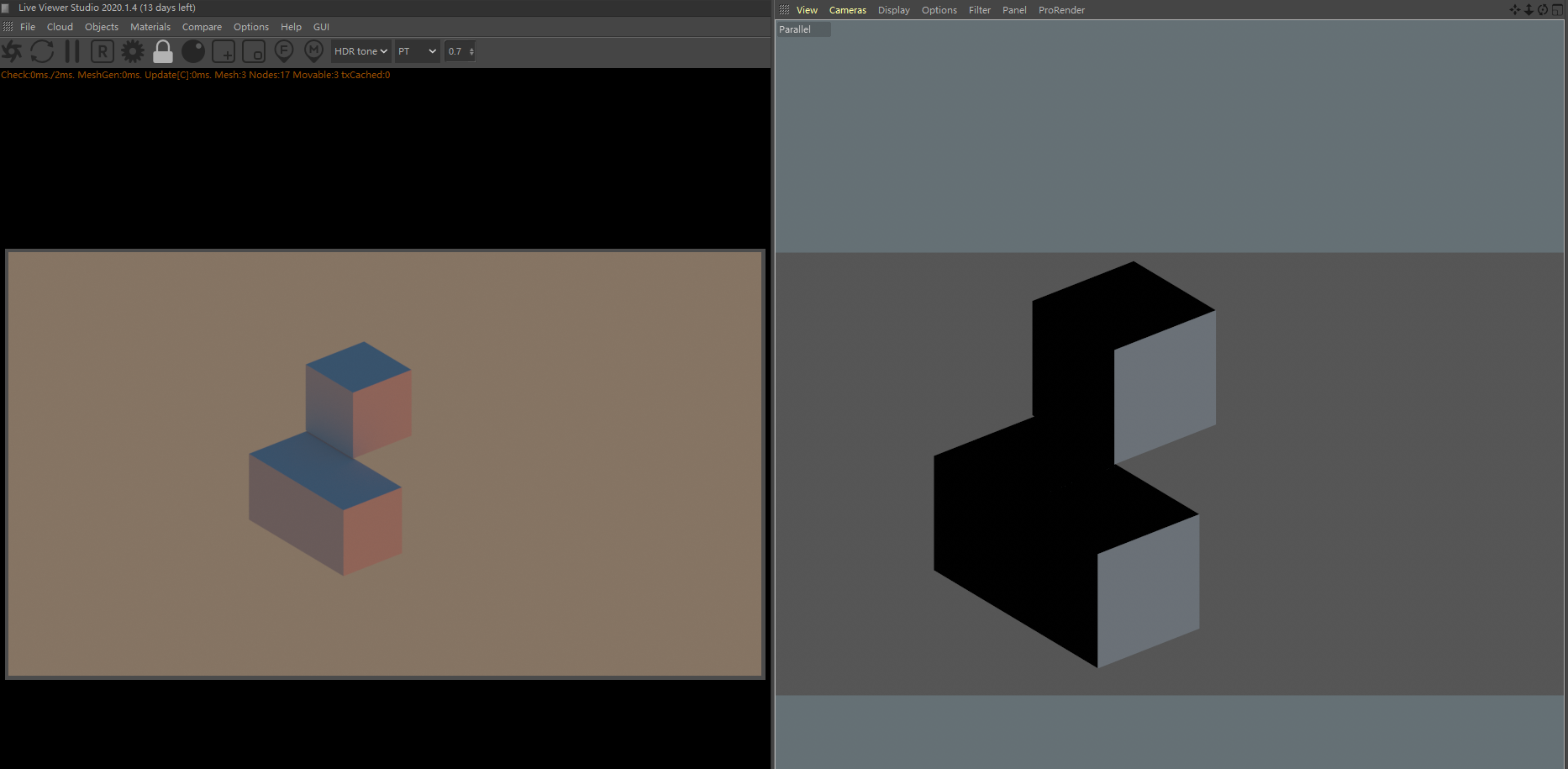

Hi everyone,
I created some scenes with a parallel camera, but if I want to push and pull the camera I have to change the value of the "zoom" which can't be work in Octane. How should I solve this problem?
Posts: 10651
in c4doctane, you need to use the Orthographic option in the c4doctane Thin lens node, and use the Focus distance for zooming in and out.
ciao Beppe
Holybear
Posts: 2
Joined: Tue Jul 04, 2017 1:00 pm
bepeg4d wrote:Hi,
ciao Beppe
Exactly, thank you so much! :D
