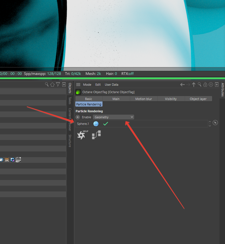

Working with particles I found out that now it is impossible to expand the geometry area. It is more than incovinient if you have more than one type of geometry.
Working on C4D R21
