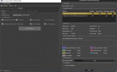

Please, go to c4doctane Settings/Devices panel, and share a complete screenshot like this:
Then share another screenshot similar to this:
ciao Beppe
