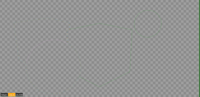

Guys! With this and previous version we experience major problems with using Gryptomattes. Basically they do not work. I've attached a picture of how it looks in IPR. I've went through the comments below this and previous version and was unable to find even a single mention about this problem. So maybe something has changed, and I am unaware? After checking in AE some of my test meshes work, and some are missing for some reason.
Please help
Luke
Please help
Luke

@Luke. please check to have the Live View mode sets to LDR-8bit, anyway the results in Picture Viewer should be saved correctly.
ciao Beppe
ciao Beppe
@bepeg4d Thx! I'll test it out
