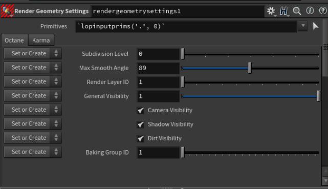

Regarding the 3. issue, please check the houdini.env Path is pointed correctly to the plugin directory.
Code: Select all
HOUDINI_PATH = "/path/to/OctaneHydraSolarisEnterprise;&"
Here is the example Octane UI in the RenderGeometrySettings.
cheers

i have that option.. but there's no option for tesselation (like on the regular octane level options)

Good to know that!! yep, agree with you. We have requested our dev if we could support it ASAP.
