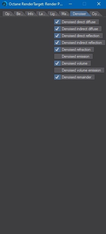

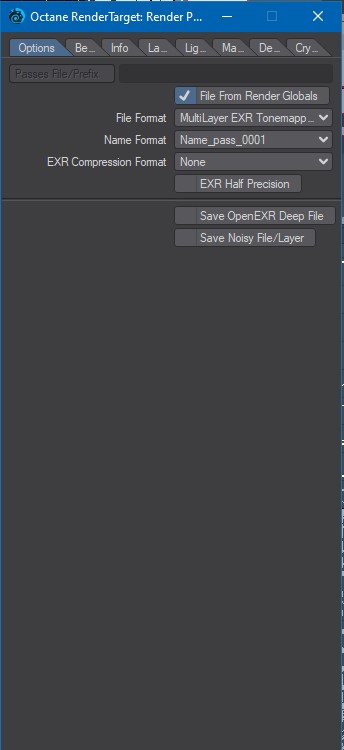

i'm exporting a movie saving out EXR multilayer with all Denoised passes.

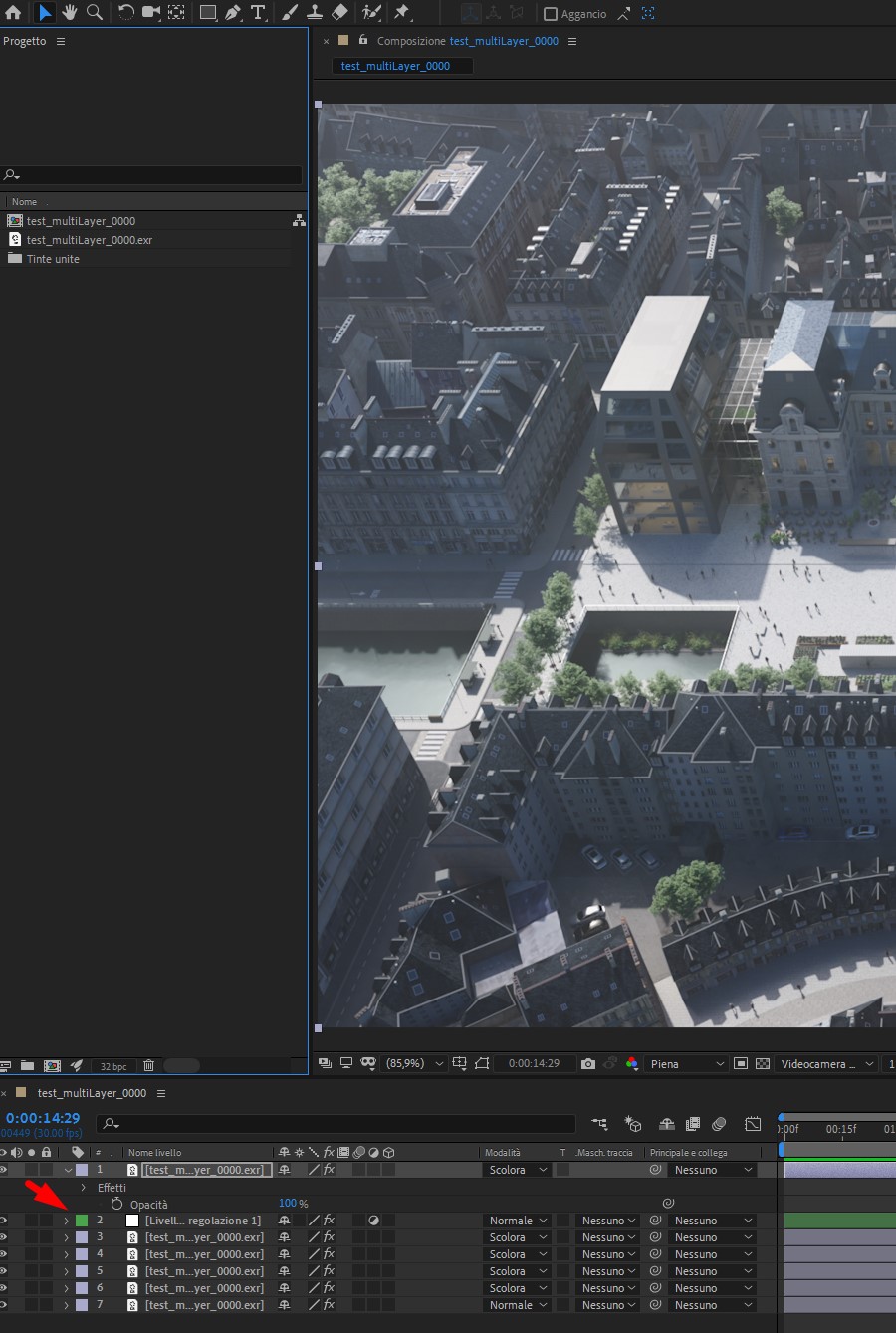

In AE i use EXRtractor to get all passes and then i stack them. I find really strange the way it behaves.
Result is overbright so i used some exposure on top of everything, BUT below volumetric.
If i just stack everything in Screen mode (or any other i tried) and then expose final result, it will never look like original rendering.
What am i doing wrong ?
Beside this, i would love to understand how beauty reconstruction should be done in AE.
Here are my settings.
Thanks,

Hi Juanjo,
thanks, i saw this - it says all passes must just be added, which is what i did.
But there is no explanation about different exposure need for single passes.
I'll stitch with my hack for now
