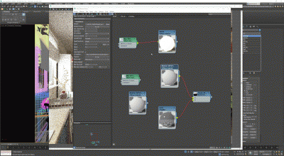

I still have problems with NVLINK. Latest drivers...all latest WIN10
Using 512MB Head Room, 64GB out of Core. 2/4 Parallel Samples/Max tile samp.
Scene would need around 24GB of VRAM. With two Titan RTX it should work.

Heymbetke wrote:I still have problems with NVLINK. Latest drivers...all latest WIN10
Code: Select all
OctaneRender Enterprise 2020.1.3 (8010300) Can't connect node 'oDiff_07 - Default' (NT_MAT_DIFFUSE, 00000194C78AC5A0) to static pin 'layer' (P_LAYER, type PT_MATERIAL_LAYER) of node 'Universal material' (NT_MAT_UNIVERSAL, 00000194C78A5640) CUDA error 2 on device 0: out of memory -> failed to allocate device memory
Take a look at this topic and you'll find some new information on the last pages.
viewtopic.php?f=27&t=74536&start=20
