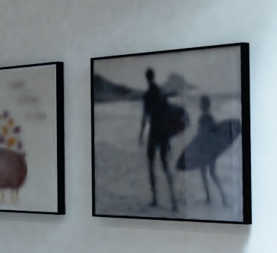

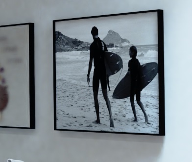

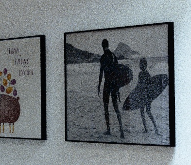

I had this problem before and posted in the Standalone area ( as it does occur to it too ) But received no answers and I thought I managed to solve it but Nope..
I have a nasty denoise problem with textures behind a glass, I did try almost everything from a simple plane to a thick polygon BUT even at 3000 samples the result is pretty unusable, attached 3 images were the blurred one is a denoise pass with a glass in front of the texture used for the frame but I have the same with a texture behind a shower glass, I don't know if I have to uncheck or check something BUT is just something I did not expect now as I'm in a middle of delivering some work.
Images are 1000 samples PT
Beauty pass
Beauty pass
Denoise pass
Denoise pass
Denoise <br />No glass
Denoise
No glass

Hi justix,
please make sure glass and image have not coplanar surfaces.
Did you try checking alpha shadow and thill wall option in specular material?
You could also try using a fake glass.
Regards
Paride

paride4331 wrote:Hi justix,
Regards
Paride
Hi Paride, Yes I did check alpha shadow and that there is no intereferences between the 2 surfaces the glass and the diffuse one, I have no Thill Wall option as I'm on 4.05-6.30 and looking at my previous jobs I never had this issue since the Denoiser was introduced AND I usually use always 3000 samples at least. Thanks for the file but I don't run 2021 up to 2018. Something went lost in translation..
