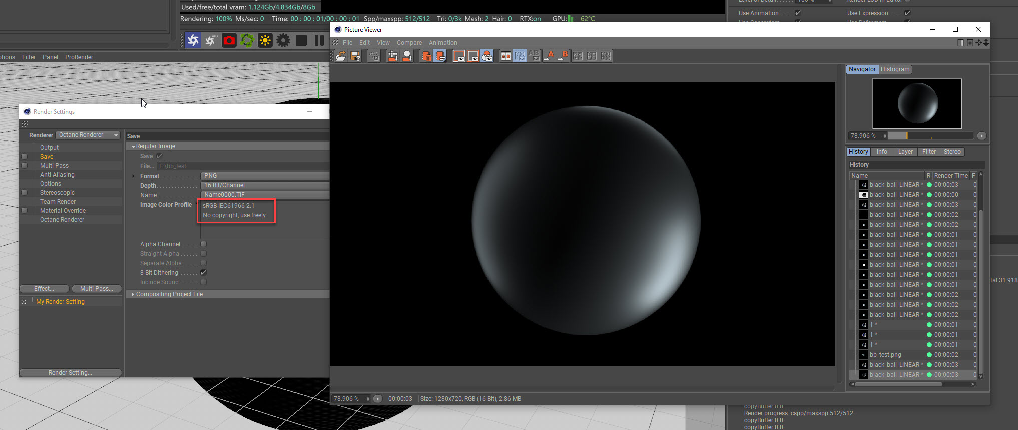

mrbrown wrote:yes, 2020.1.3-R2
Here is! Your problem is because of "Image color profile". All good when you keep as "sRGB". See picture
banding_issue_octane.zip
(4.62 MiB) Downloaded 202 times

Hi Aoktar,
Thank you but I would like to save in linear color profile as It seems to be the best way to work with passes at least in Photoshop.
I think it is also worth mentioning that I've been working this way for a long time, I'm familiar with the settings and never had issues with prior version on the plug in.
In any case, I've been talking with Beppe and Jay from support and I've been told that this is an issue that is solved in a new version of the plug in that hasn't been released yet.
So I look forward to that update.
Thanks!
Posts: 16068
Location: Türkiye
I have done changes as developer of this plugin. Maybe old behavior was wrong!
And why do you set it from this parameter if you need passes in linear? Correct settings are under octane passes. Your settings is just corrupting the colors that are generated by plugin in linear color space.
