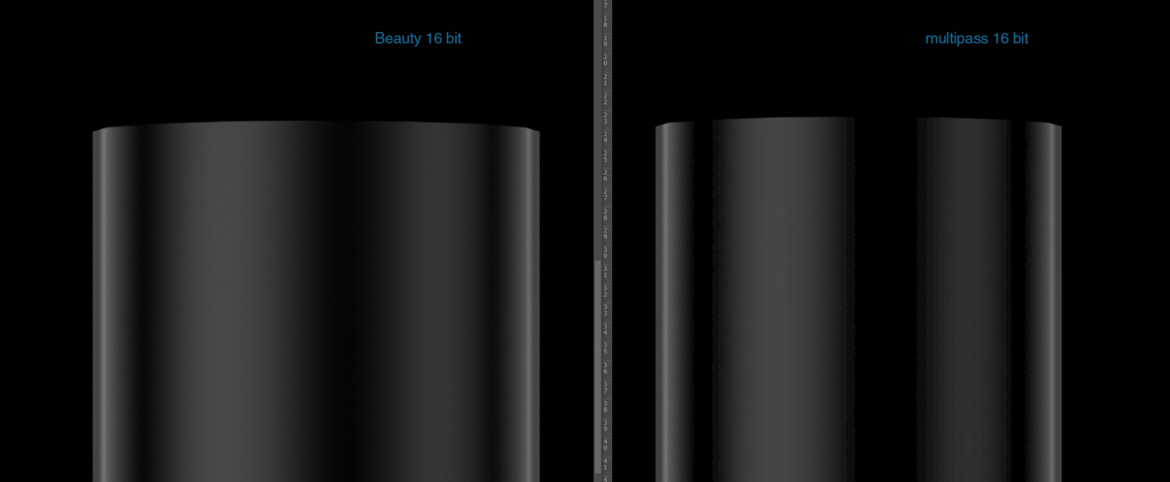

having some gradient banding issues in the render passes file.
The scene is simple, a black cylinder in a black scene.
The live viewer and the beauty render show the cylinder correctly, with smooth reflection.
the reflection layer in the render passes has very strong banding.
The render buffer is set to "tonemapped", camera images is set to linear and so is the render passes image color profile and tonemap type in the render settings.

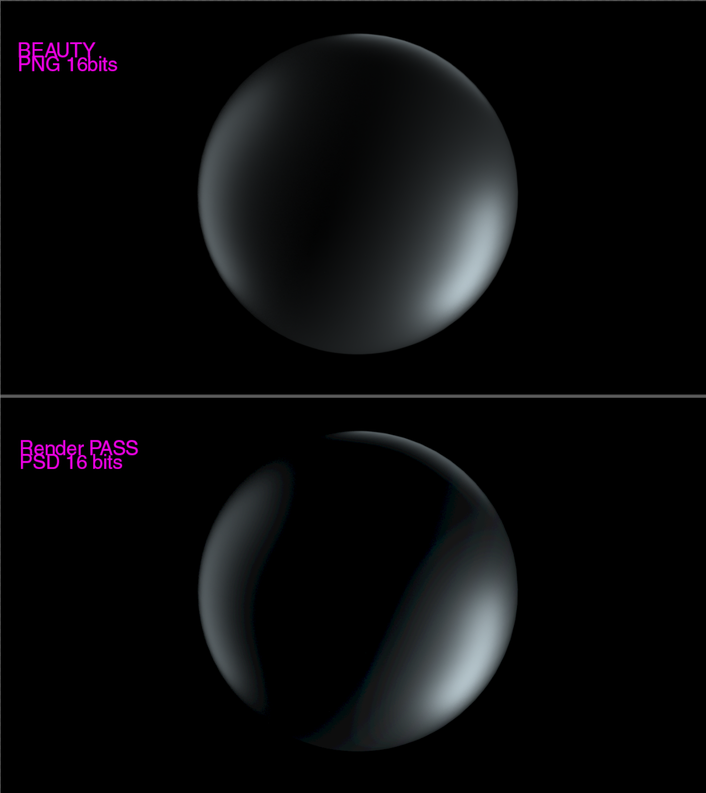

So I did some additional tests and here is a super simple test scene.
It's a black sphere in a black environment with a 3 light set up.
I rendered a render pass with diffuse, reflections and material ID psd 16bits and a beauty png at 16bits.
I tried many combinations and setup, different files format but can't manage to get a render pass at 16 bits without gradient banding.
I also tried exr 32bits.
That works, but then the problem is that I can't edit the image in Photoshop (many photoshop tools don't work at 32 bits) so then I try to convert to 16 bits the image doesn't look right anymore.
I would really appreciate if anybody can help me figure this out.

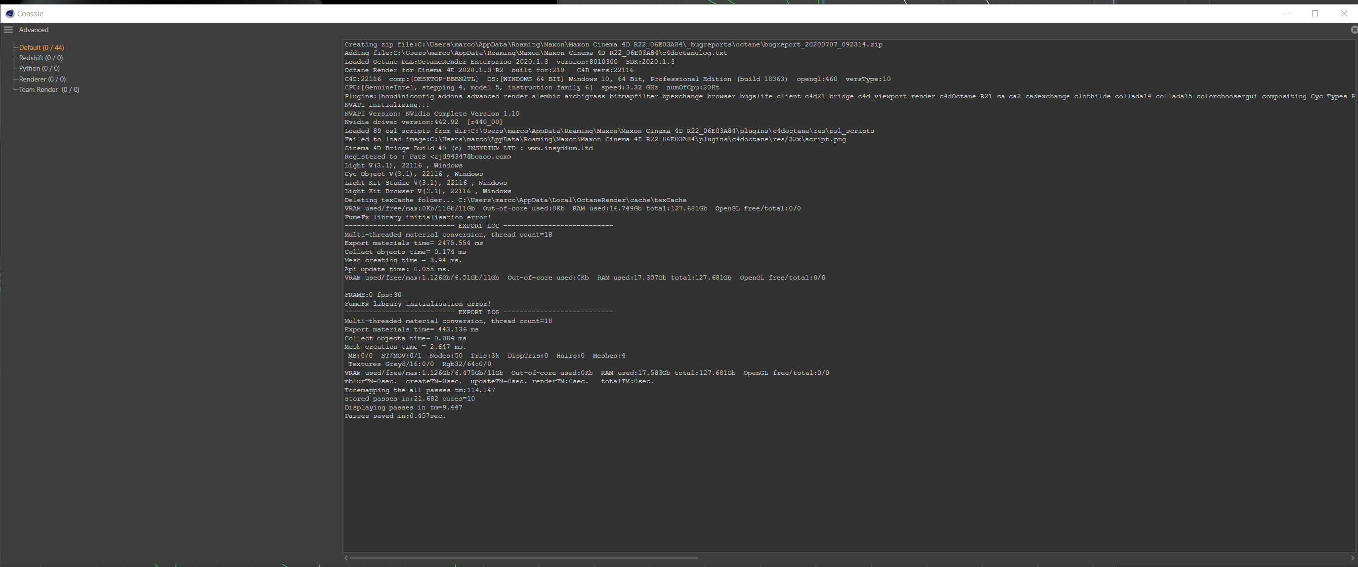

the issue should be already fixed in 2020.1.3-R2, please, go to c4d menu Script or Extensions/Console, (Shift+F10), and share a complete screenshot of the panel, thanks.
ciao Beppe
ciao Beppe

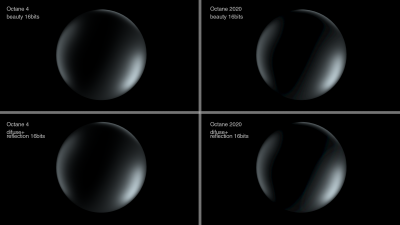

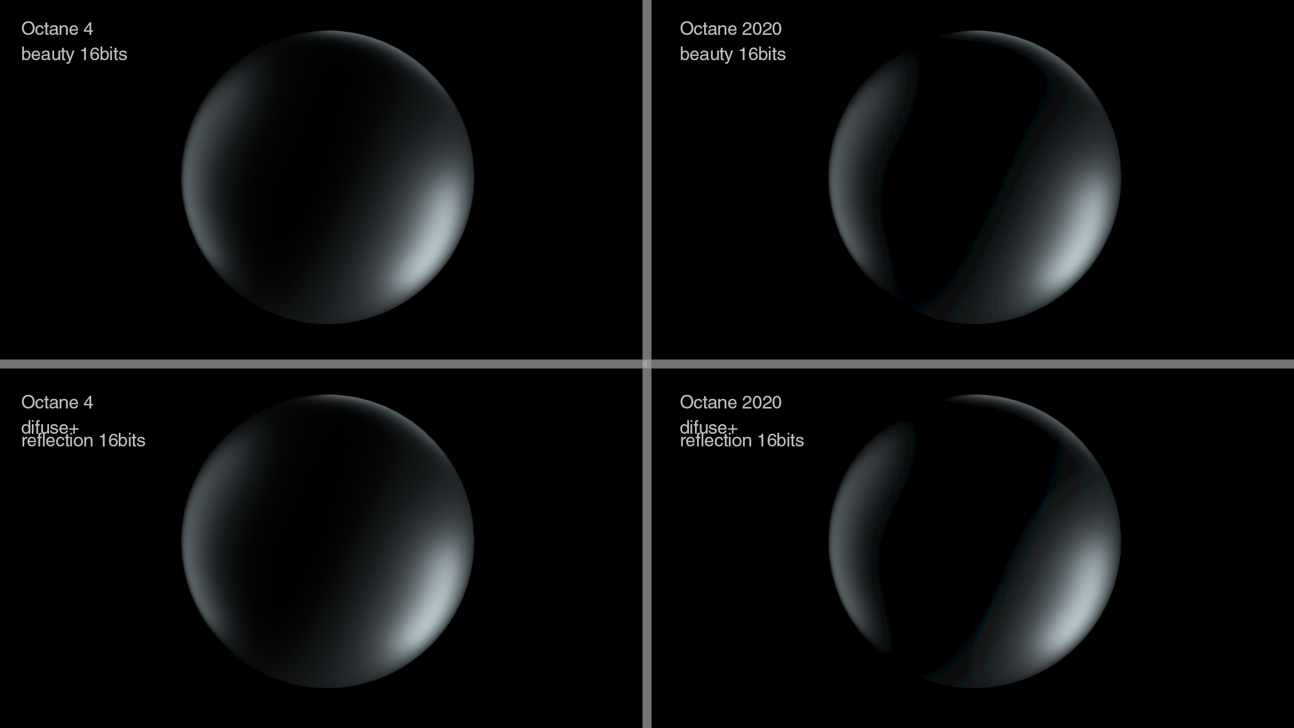

I've done some more tests and I came to the conclusion that there are discrepancies between the Octane 4 and the Octane 2020 plug-in.
Please take a look at the scene attached. It is set up for Linear workflow.
- If you open the scene with Cinema and Octane 4 (4.07-R7) and save a render pass you get a PSD layered file at 16 bits with no banding and the diffuse and reflections can be added in Linear Dodge (add) correctly and the result is exactly the same as the beauty.
- If you open the same exact file with cinema and Octane 2020 (2020.1.3-R2) and save the render pass it does not work the same. the PSD file has very strong banding and it is basically unusable.
Can you please explain why is this happening and what should be done to achieve the correct result with the latest plug in?

Thank you but I need the output to be in linear color profile.
