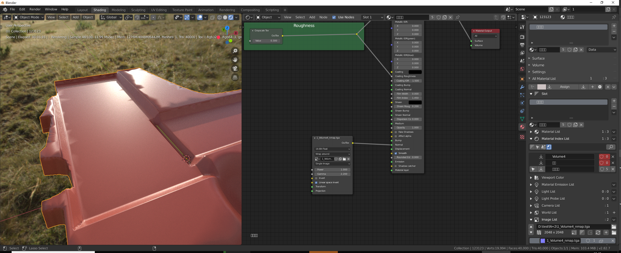

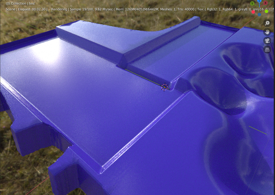

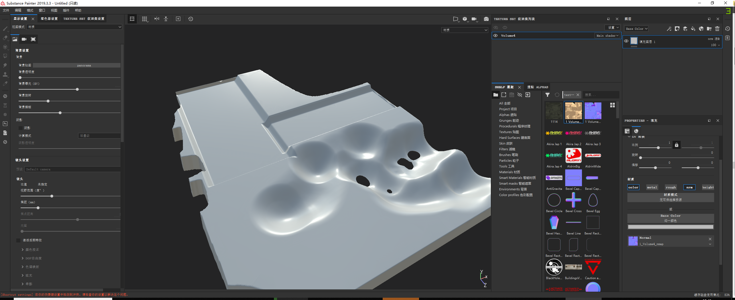

I baked the normal map of the 3D model in 3dcoat, and I imported the normal map into Substance Painter, there is no problem.
However, the normal map is not displayed correctly in Octane.

The normal map is displayed correctly. You can even see the errors in the Normal map texture that you attached. Your bake is not good.

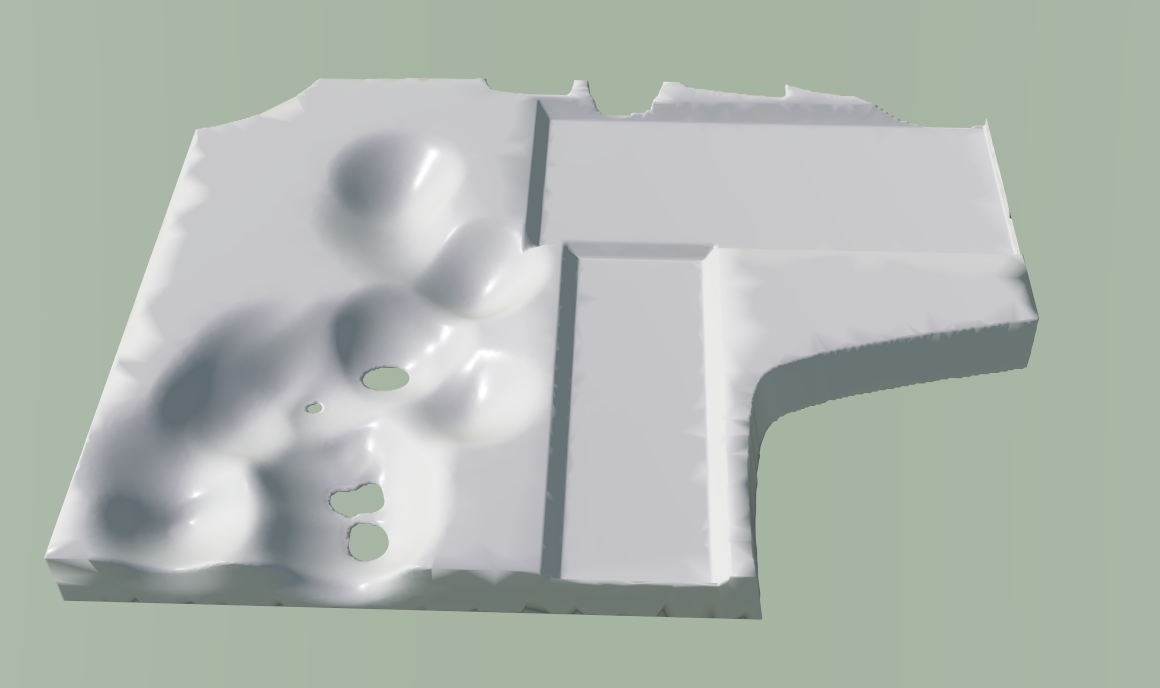

Here is a screenshot of your OBJ from Houdini Viewport. You can see the same thing happening. I'm guessing your normals didn't export the way you wanted them.
