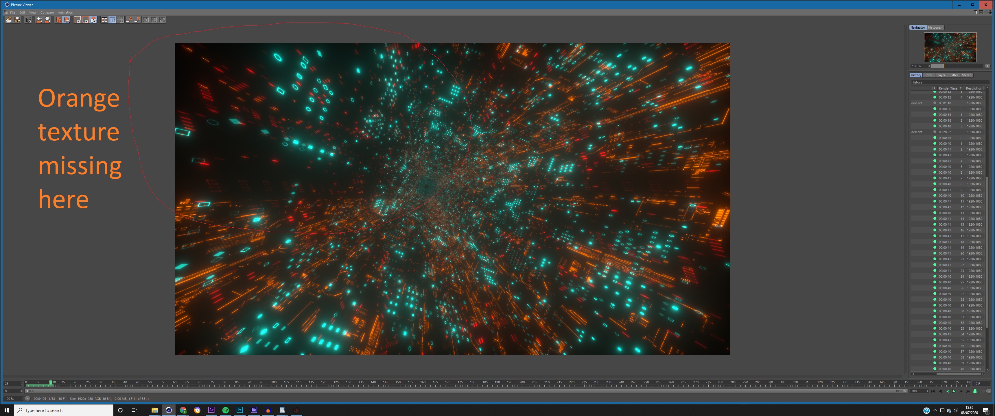

Got an intermittent one here. In the picture viewer a mix texture (Emissive texture using a dirt node to find edges of an 8k displacement map) doesn't render on random quarters of the picture viewer. The first frame is usually fine then there are problems on the rest. It only happens when i am using a slave to help with rendering.

Quick update- tried to limit the slave to only using the 2070 super and not the 980ti and it still happened 8(
Please see the problem here:
***Another update***
Seems to work fine with only the slave 2070 super and 'minimize net traffic' unchecked so perhaps the 980tis are the problem...

No, there were no errors in the slave deamon window. It's now working fine but only if I turn off the two 980tis... Which is a shame cos it slows me down 8(
