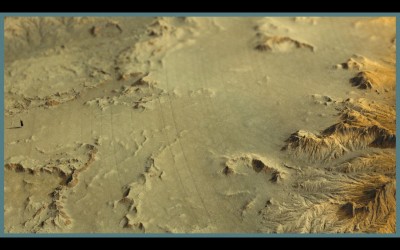

hi there,
thanks for all your help so far... I'm just starting with Unreal (and Octane in Unreal) and I'd like to continue with it...
I noticed in my scene that in my Landscape Displacement there are strange Circlelines.
The whole scene was imported as Orbx, in Octane Standalone there are no such artifacts...
orbx displacement map -> strange circlelines

Adjust your ray epsilon it should go away.

EvolverInteractive wrote:Adjust your ray epsilon it should go away.
Good chance this would fix it yes.
Other than that: Are you using orbx proxy import or orbx import and the latest build?
i used the 0.36 version and orbx import

Could you try using the latest build? Also, did changing the ray epsilon work?

i will try the latest build...
thanks for your help,
