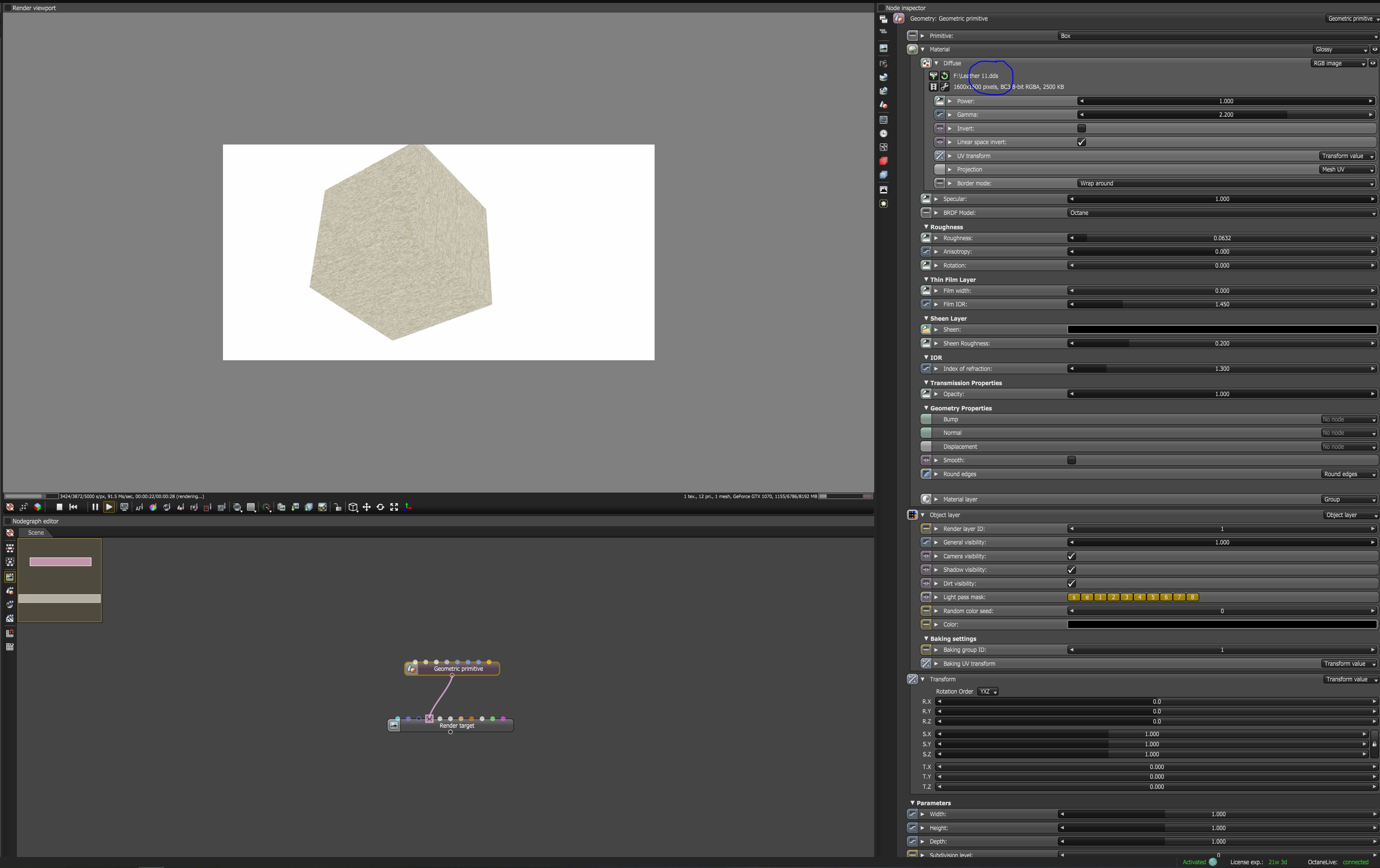

Postby nick73 » Fri Jul 10, 2020 12:42 pm
nick73 Fri Jul 10, 2020 12:42 pm
Here,
Thank you!!

Postby face_off » Sun Jul 12, 2020 10:47 am
face_off Sun Jul 12, 2020 10:47 am
DDS image file support is in the next release of the plugin.
