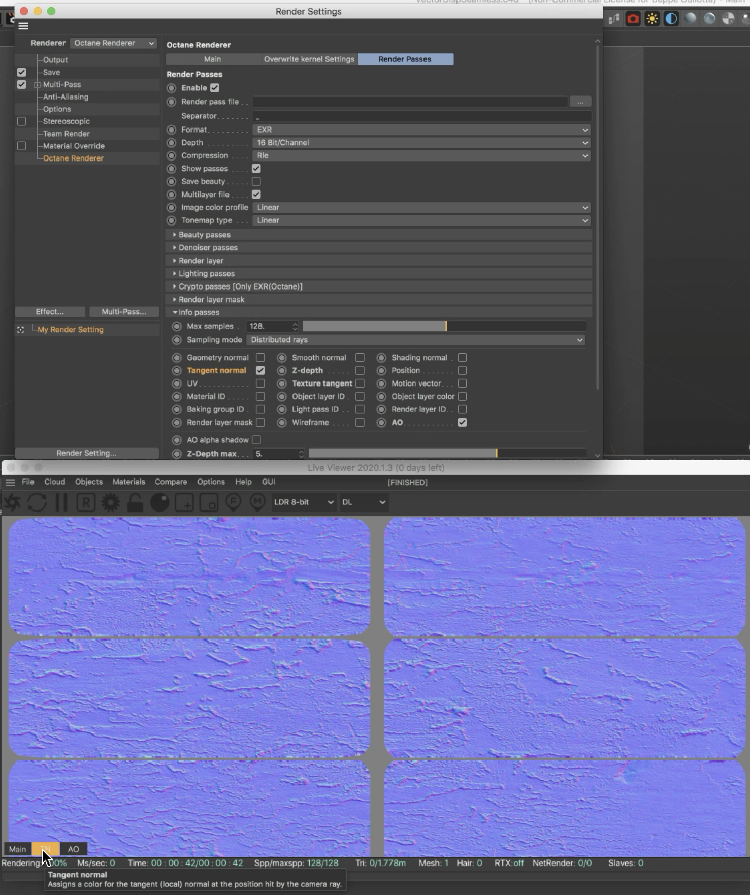

you can also use the Tangent Normal pass, but it works only with Bump and Normal maps, not with Displacement: ciao Beppe
