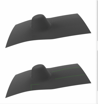

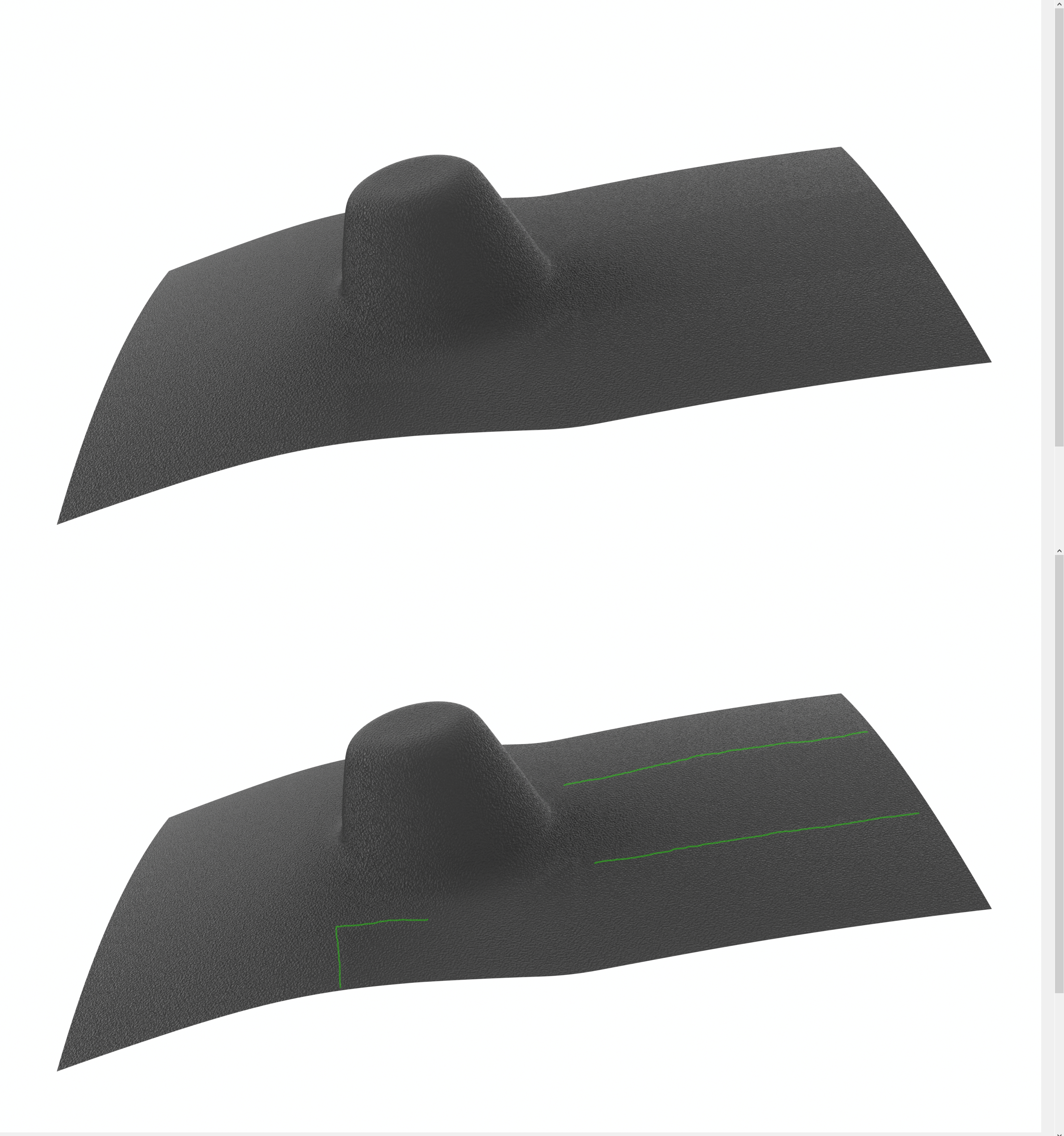

I have noticed sometimes I have artefacts on Bump map. See render below:
You can see (depending on camera angle) that there are some shading/lighting artefacts (edges marked with green).

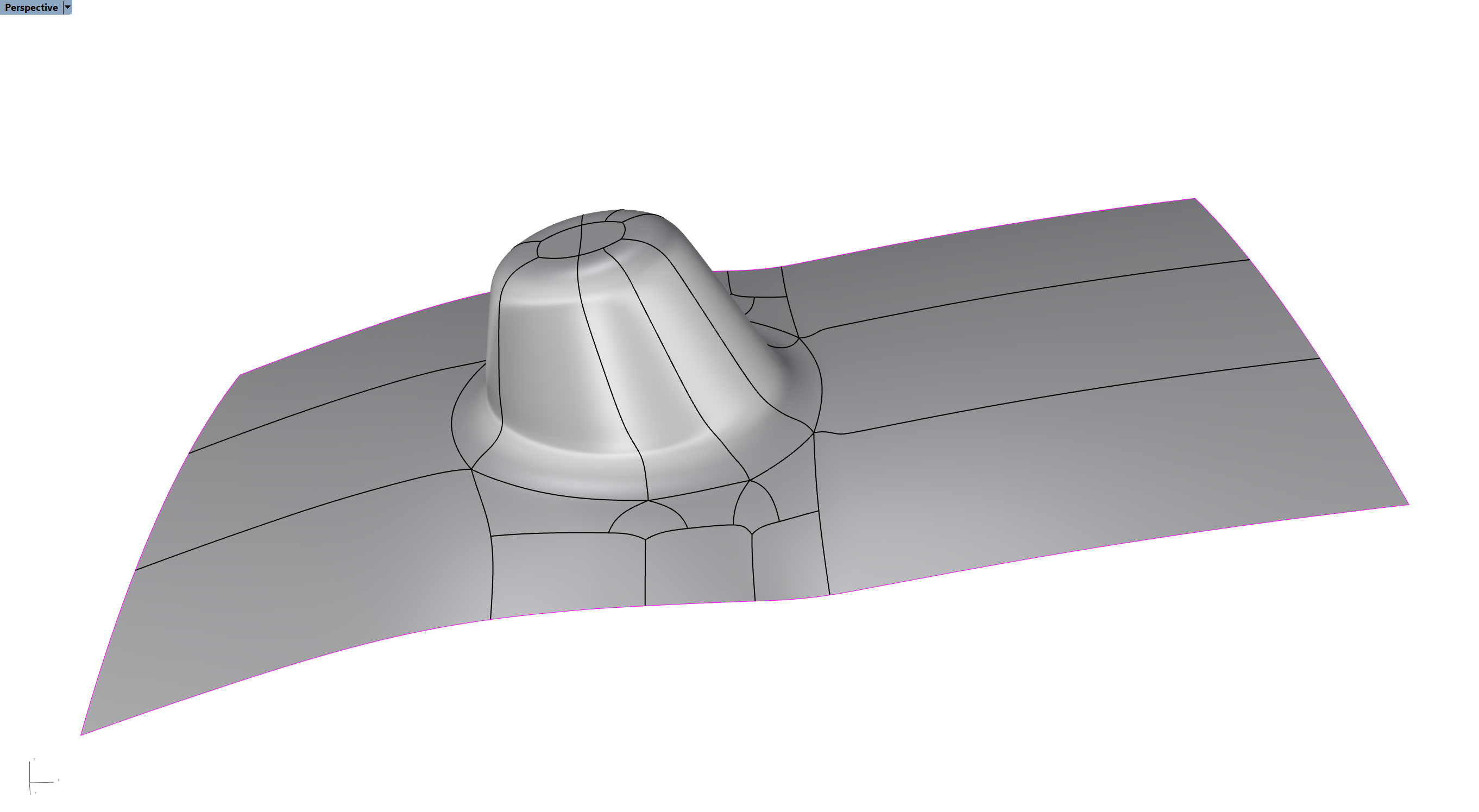

If we compare to the Polysurface, you can see that artefacts appear directly along surface edges:
BTW, surface was created with TSplines for Rhino5. Is this the core of the problem, maybe??
So, why those artefacts appear?? Is it related in any way to "Shadow terminator" issue ?? or something else??

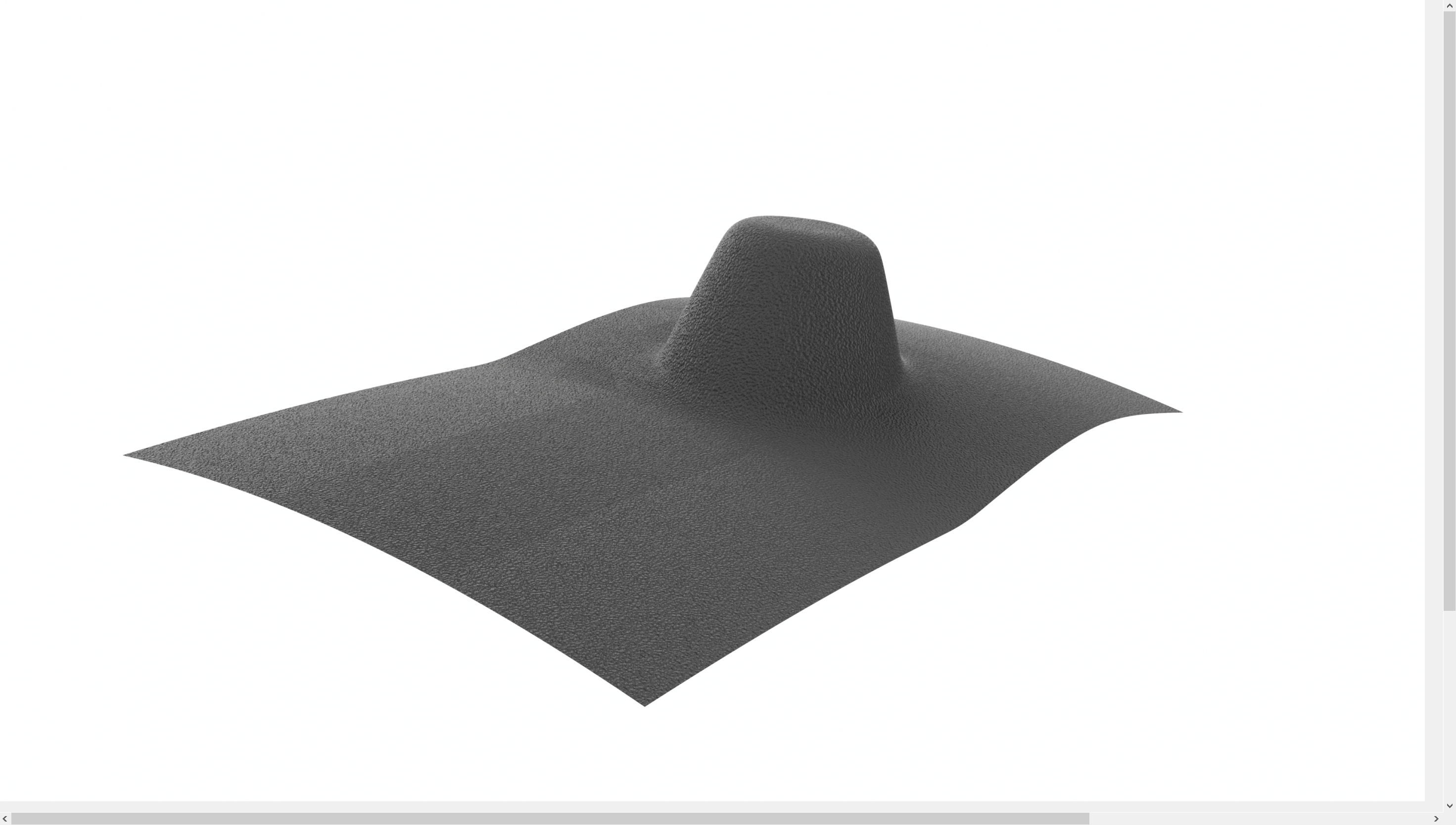

Might be a scene scale issue? Can you check the rayepsilon slider in Kernel?

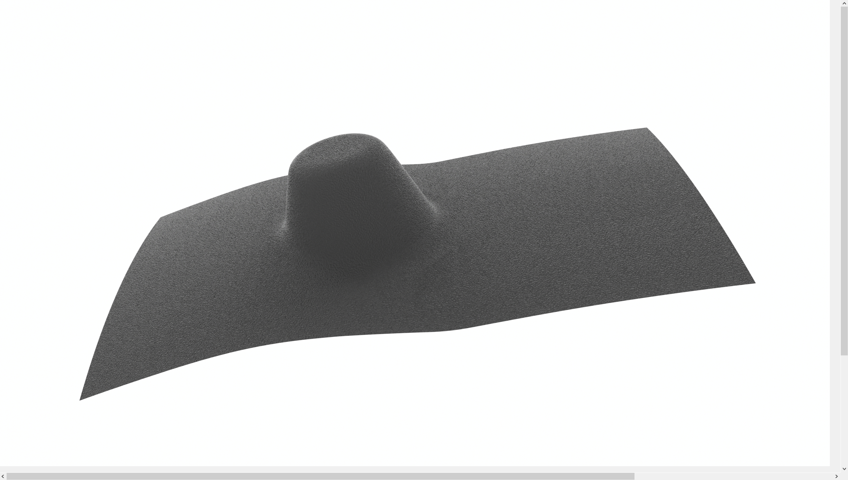

I didn't get any artifacts when I rendered your scene. I could be a shadow from your environment map.

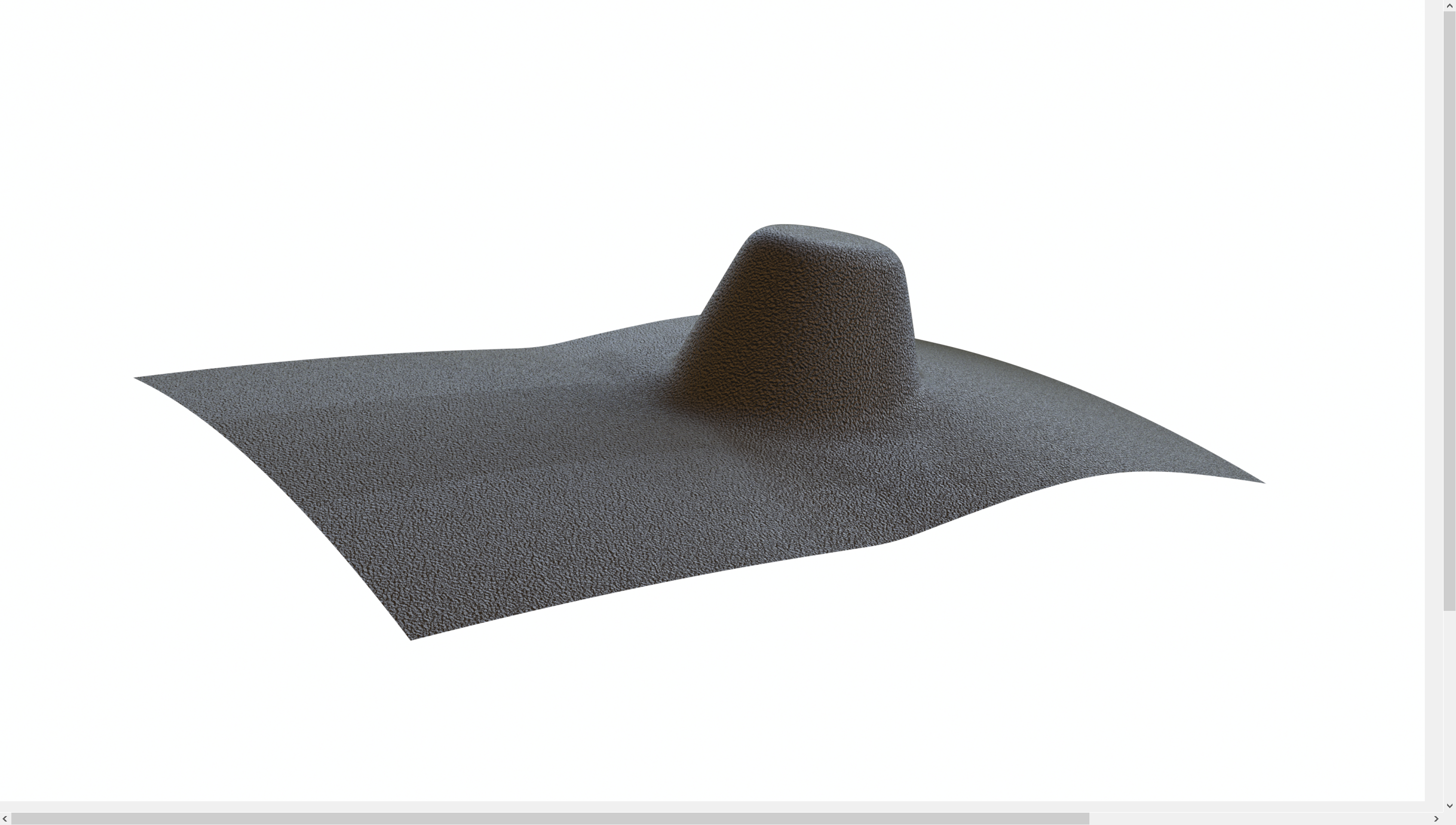

I tried to adjsut Ray Epsilon slider - no effect on the result, still seeing artifacts.
I've tried with multiple different HDRi . With some of them its less visible (but still present).
Any other guesses?

I'm using tri-planar mapping here and Octane noise texture for bump.
whersmy
Posts: 723
Joined: Thu Aug 30, 2012 7:40 am
Looked it into it, and yes, it is weird. It becomes way better visible when using a really small scale noise texture. When using a larger scale (though probably not the user-case) it`s not visible.
