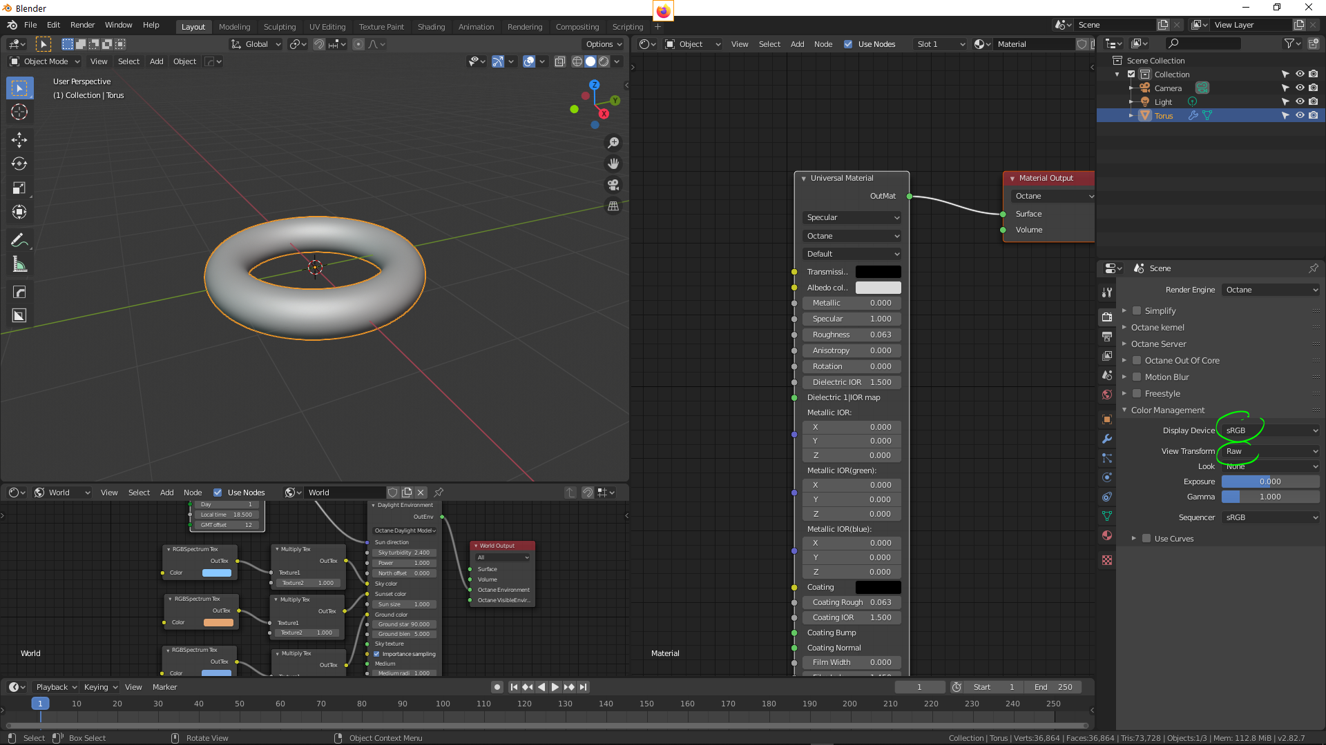

I suggest a slightly different method that can be really useful if you want to work with a color corrected OpenGL but still preserve the fact you can use Octane's color correction tools.
Just leave Display Device to "sRGB" (do not set it to "NONE") and be sure to select "Raw" in View Trasform. That way you'll be able to work with an sRGB OpenGL view and also correct colors in the Shader Editor.

Thanks linograndiotoy, it does work
