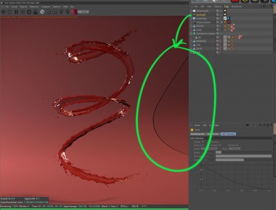

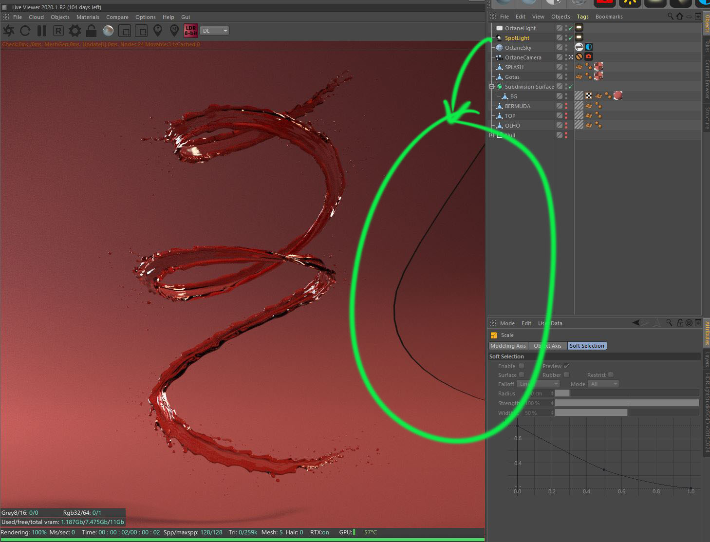

Hi Octaners,
I got a newbie question.
Why do I get this dark egdes projected onto my surface while using Octane light (Both area and spot light)?
How do I get rid of it?
Cheers,
Daniel

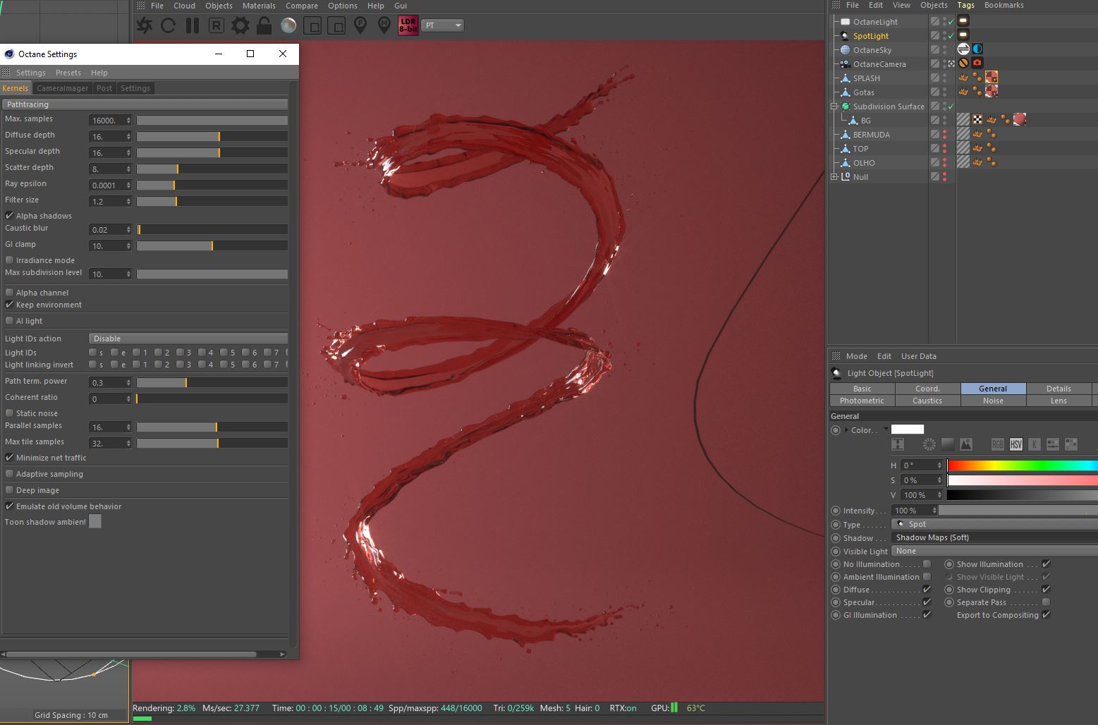

Hi Beppe,
Just changed to your settings (Pathtracing and 10 GI Clmap) but still having same weird behaviour.
Posts: 10575
difficult to say without the scene, it could depend from reflection or refraction, or geometry thickness and normals :roll:
You can use the Multi pas system to split the render and check where is the issue, exactly.
Try to enable the Thin wall option in the Common tab of the Specular material, to remove the refraction/thickness effect, to see if it helps.

What is your scene scale? Try adjusting the rayepsilon perhaps :)
