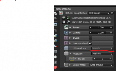

It seems that C4D creates empty uv transform nodes, which the converter didnt expect, resulting in random UVs.
If you want to have this working before the new build you can fill the UV transforms with the default 2D transform node before importing into unreal.
Example of empty uv transform:
