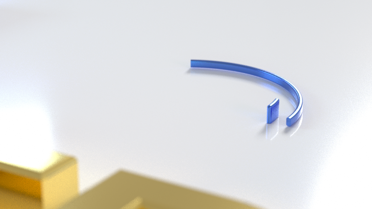

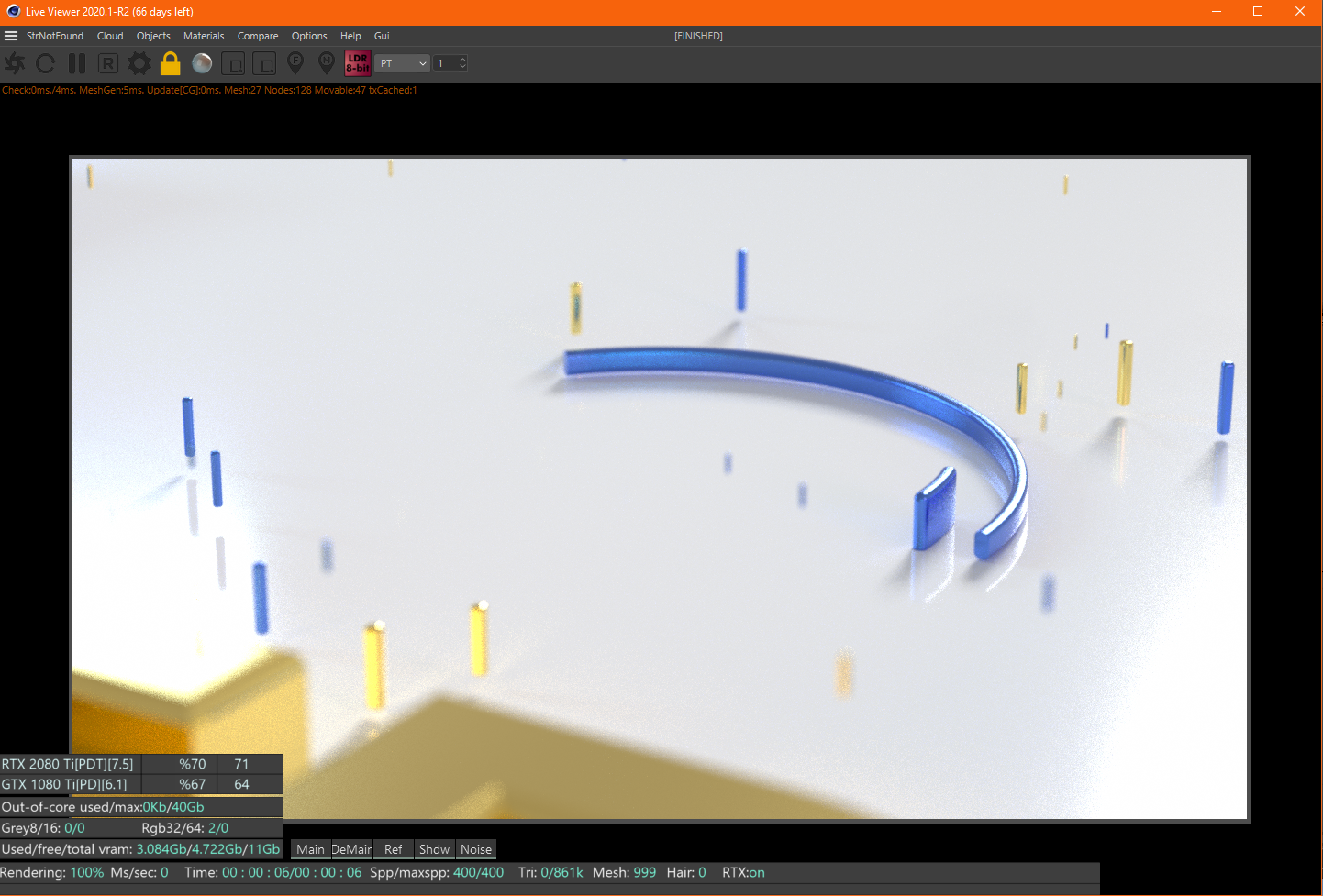

I have an issue with my render, when i make a multi instance cloner, we d'ont see the cloner in the render, but in the live viewer it's ok. (see in attachment)
it's work if the cloner is in "instance" but the scene preview & scene loading in octane is really slow
Best

scene please

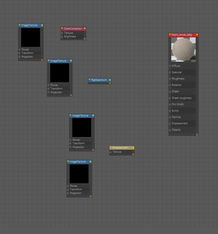

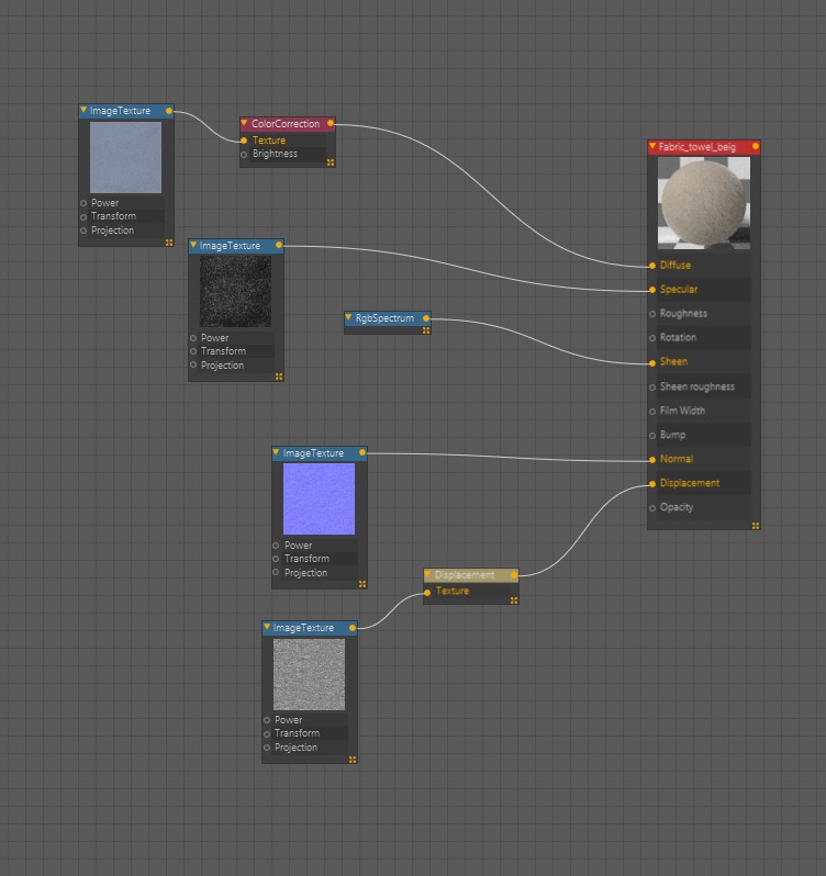

I wanted to show you an odd thing about node editor.
When I select one material already set in my previous scene I don't see node connections, they work but I don't see them.
If I select another material and then I come back to that one I see conenctions...
Is there a way to avoid this annoyance?
Thanks a lot and have a great day!

Asking to understand. Displaying a material and changed scene and connections are disappearing?
shine71
Posts: 138
Joined: Sat Mar 15, 2014 5:16 pm
Hey Ahmet! :)
Thanks for the reply.
Simply opening a scene that I did with R2, selecting a material and watching node editor conenctions are not visible.
If I select another amterial and come back to previous one I see them.
Nice thing is that each node works even if I don't see connnections, so they are there but are not visible....
