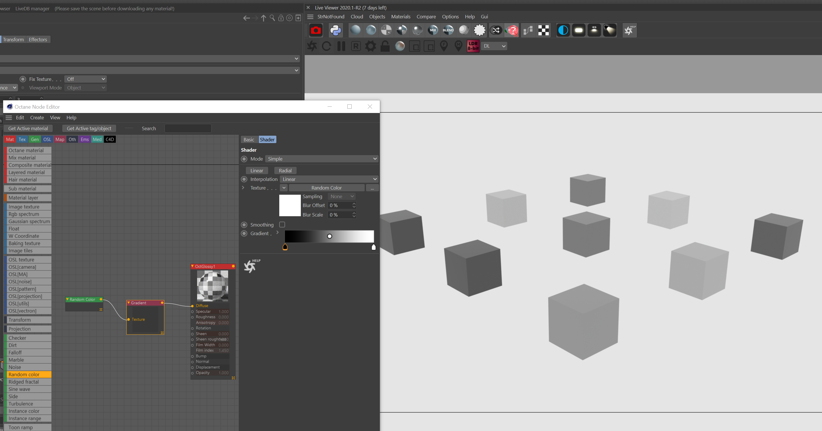

franchais wrote:Hi I'm having trouble getting the random colors to work?
The attachment random color.PNG is no longer available
Any idea on whats happening?
Hi franchais
the solution is very simple. Do you have selected "render instance" or "multi-instance" on Cloner? If you leave the default "instance" it doesn't works! Please select the other two options, it works!!!
