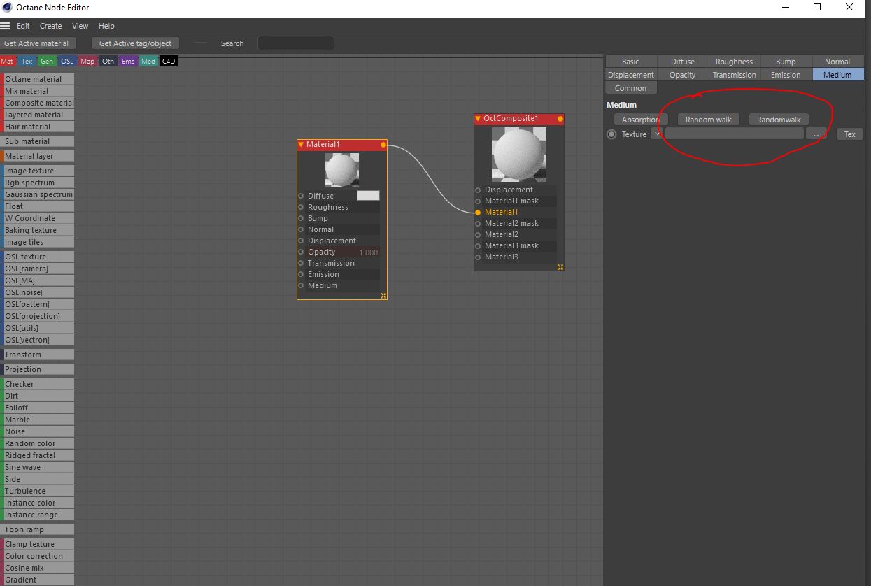

I think this was mentioned somewhere before, but is there a difference between "Random walk" and "Randomwalk"? :D
