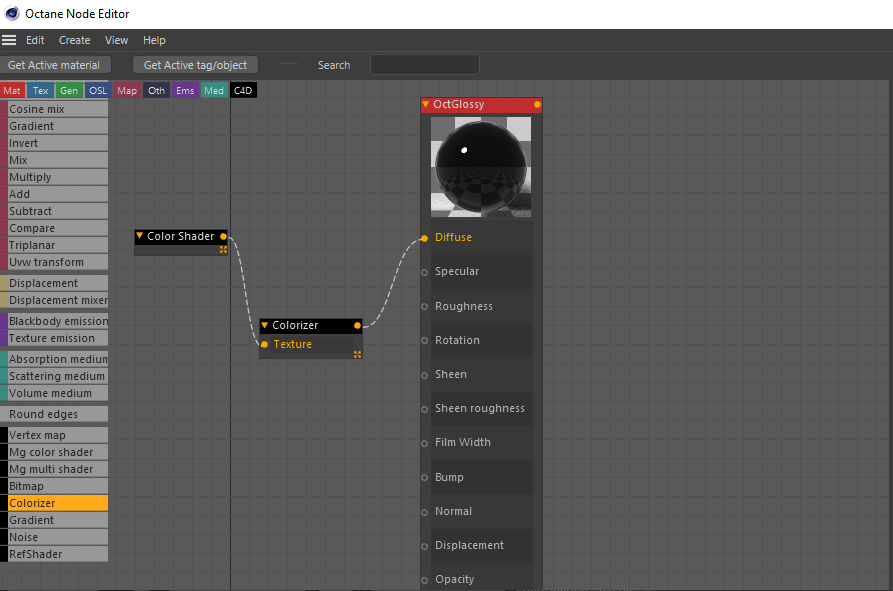

So I have a very basic setup in my octane node editor (Mg color shader -> colorizer -> diffuse)
As you can see here:
However I got this material by copying/pasting from a previous file I had created, and the node material works great however here is what happens if I try to make it from scratch.

Posts: 10618
Please, avoid to use any kind of c4d shader.
Instead of the MoGraph Color shader, that works only in simple Instance mode, set your MoGraph cloners to Render Instance, or Multi Instance, and use the Instance Color node instead:
http://www.aoktar.com/octane/InstanceColor.html
You can also use ther Instance Range node:
http://www.aoktar.com/octane/InstanceRange.html
