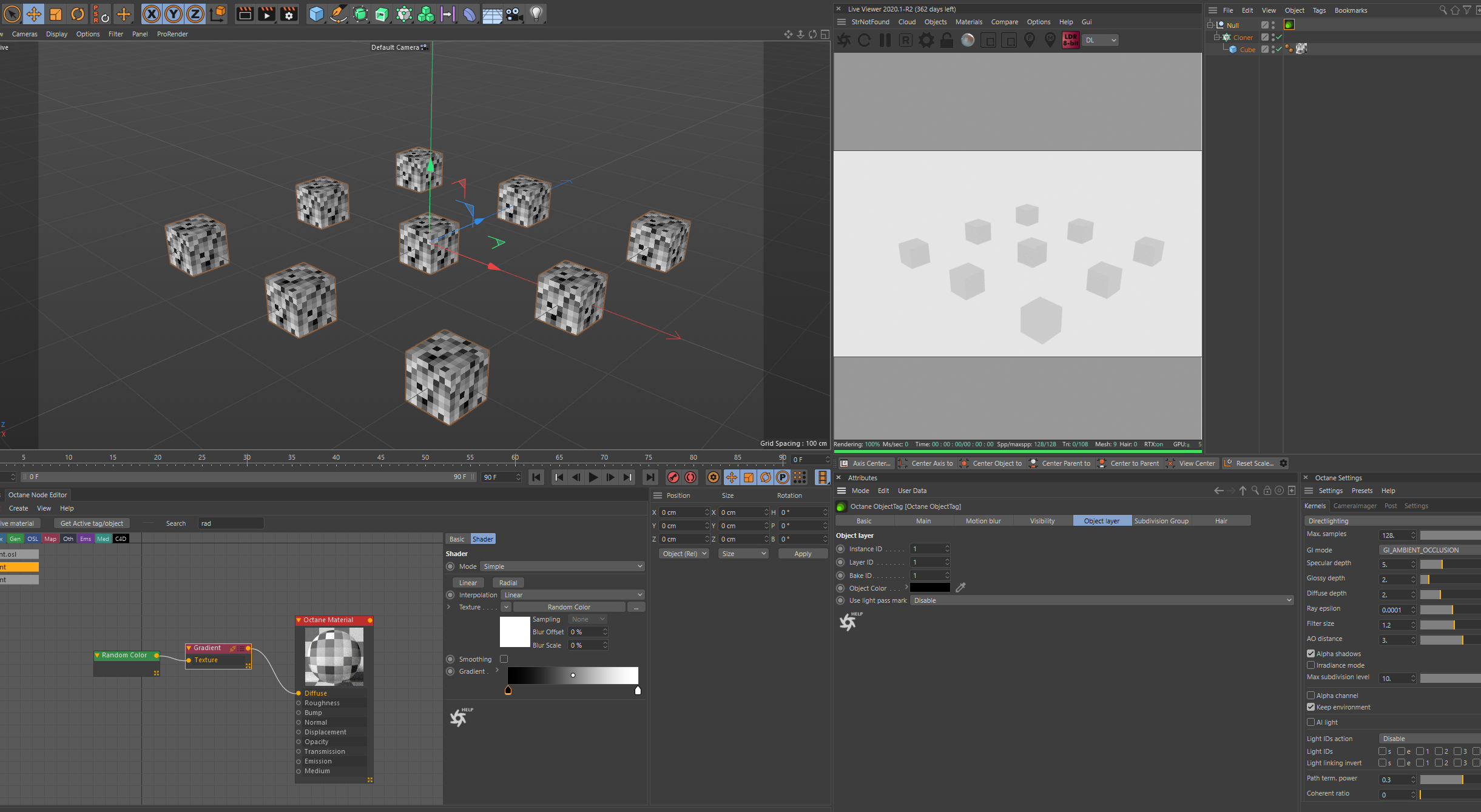

Hi I'm having trouble getting the random colors to work?
Any idea on whats happening?
I7 2600k | EVGA gtx 680 FTW 4gb | Win 7 x64 | 16gb RAM
Posts: 10649
Hi franchais,
have you enabled the render Instance, or Multi Instance option of the MoGraph cloner?
ciao Beppe
