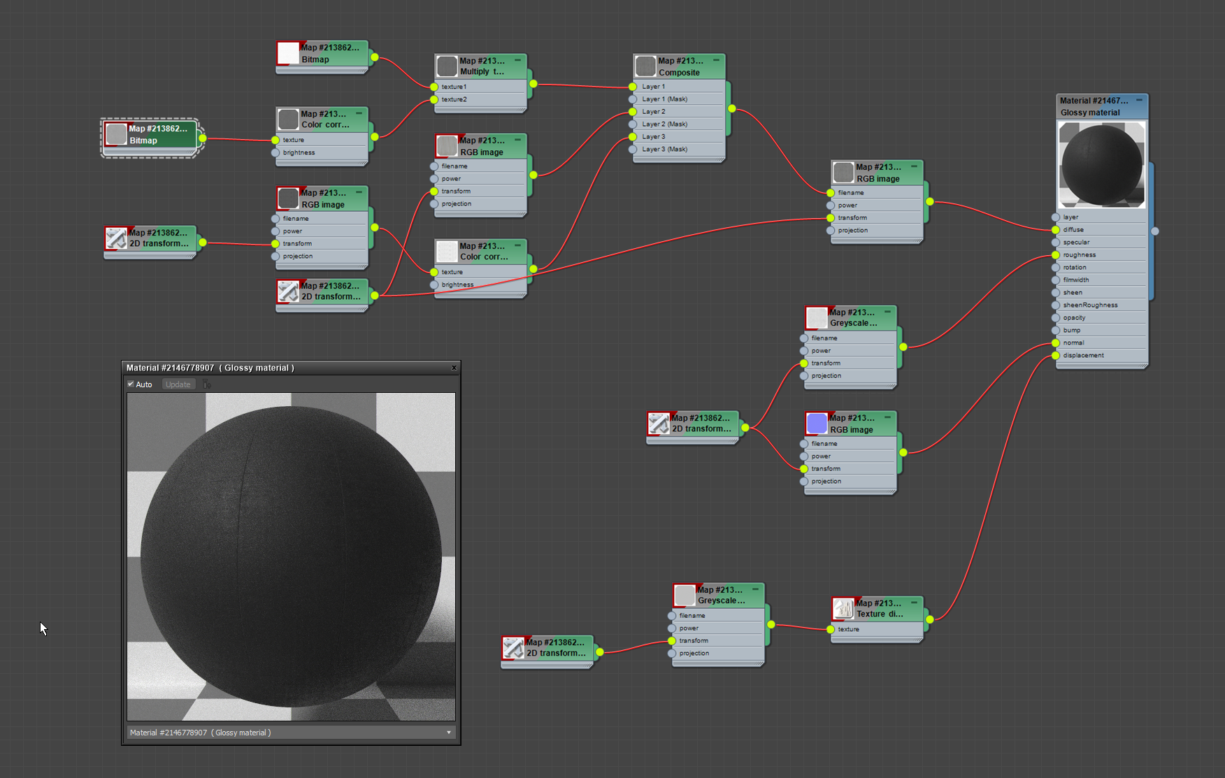

Hi
on my Studio subscription at home, Bitmaps are working just fine ... but on my Enterprise Subscriptio in the Studio, does not support Bitmaps ...
