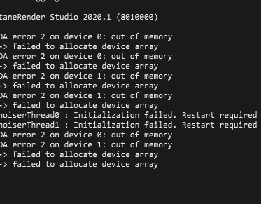

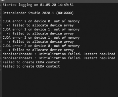

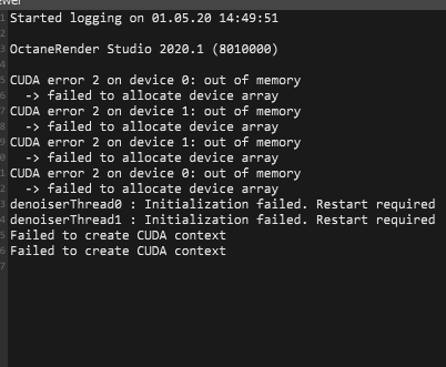

Yet for some reason, when I try to open the scene and allow textures to be found with octane many time it crashes c4d. On occasion it allows me to try and render, but gets stuck at 49% and comes up in the log with the following.
First screenshot is with my normal settings.
Second screenshot is with any texture optimization disabled, alpha/opengl/multicore,multiform,

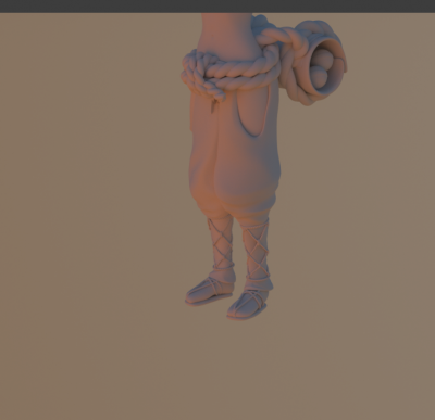

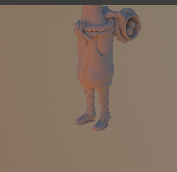

Last screenshot is showing the model renders without textures
I've emptied the tex cache as well.
My guess is maybe it has something to do with the dirt shader?

Normal settings.
Normal settings.
Texture Optimized settings off
Model renders with no textures

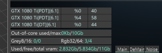

-- UPDATE --
Deleted Dirt Shaders, doesnt seem to have fixed the issue
Still with 5GB of 11 free..
