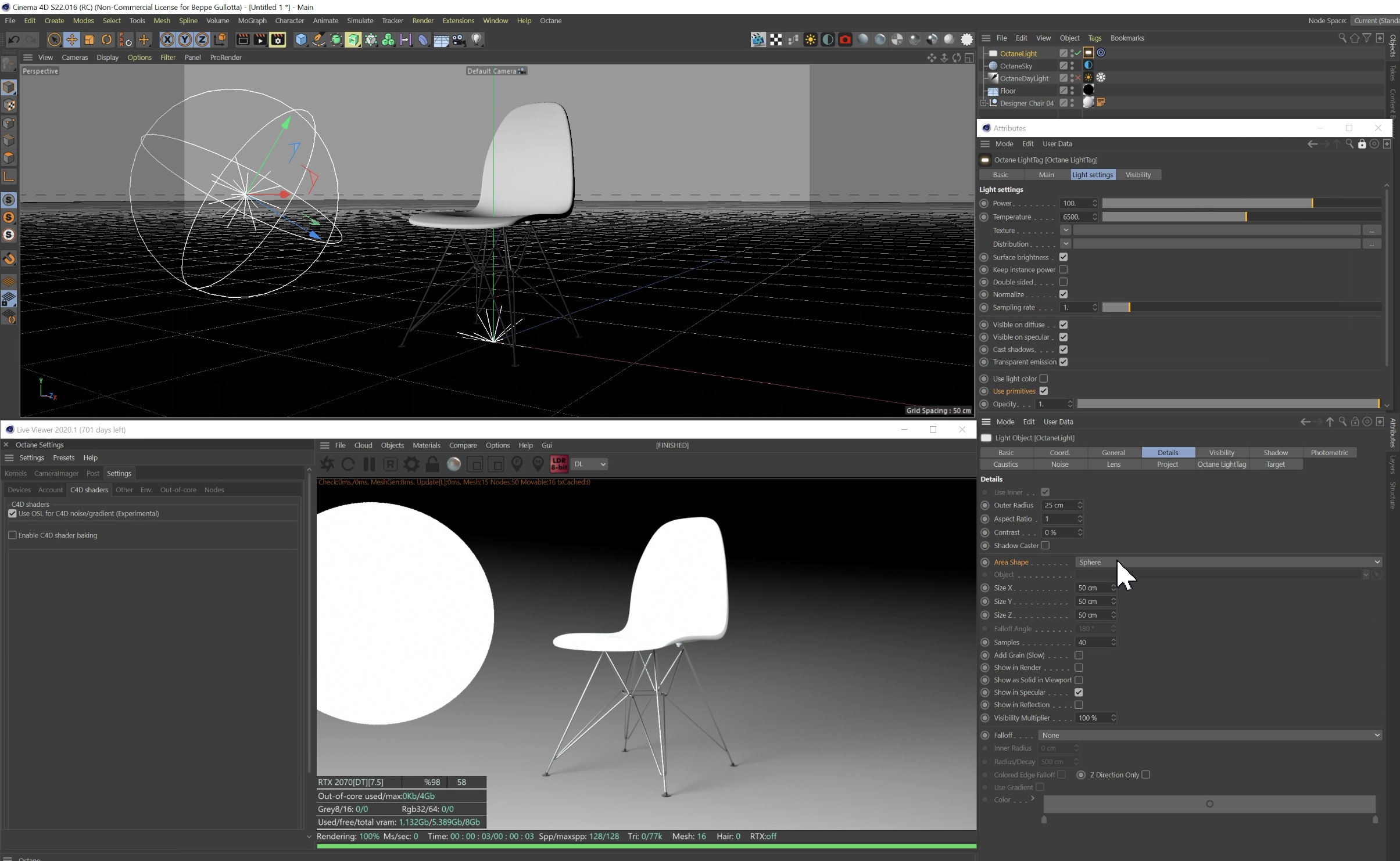

no problems here with Primitives Lights, in both Rectangular and Sphere mode, the lights are moving correctly in LV:
Could you share an example scene that shows the issue?
ciao Beppe
