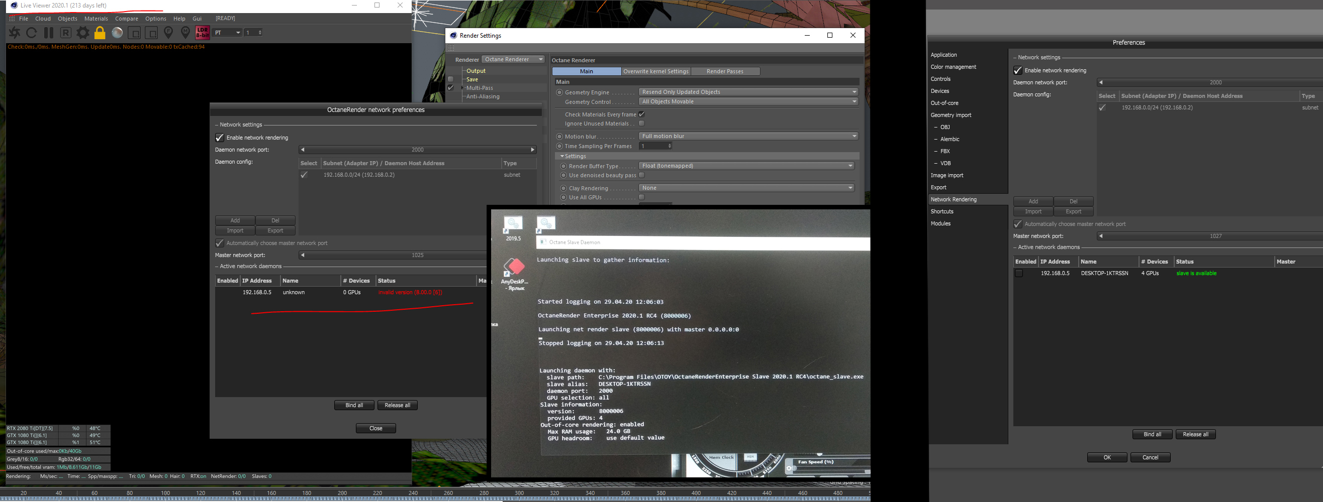

Hi. Ahmet you released 2020.1 version, but i can't run render with my slave node.
Standalone works well. Can you update version? My commercial project production too much slow now.
