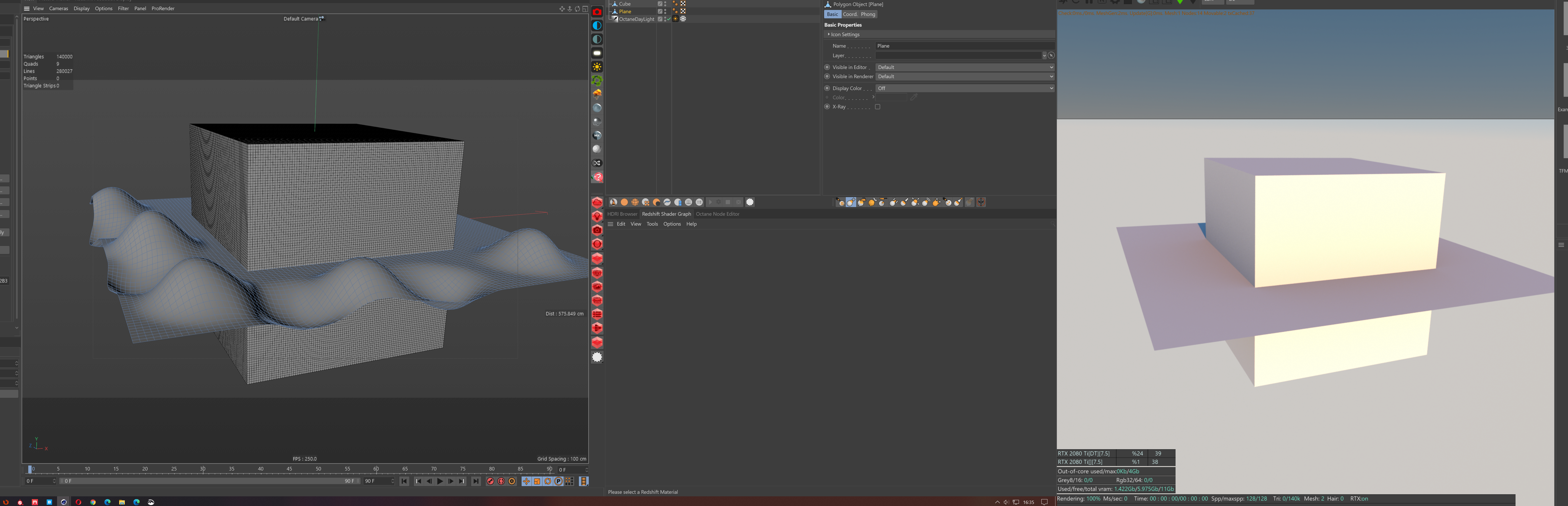

Yes i get updates move objects, and i try empty plain no texture just 100x100 subdivision results are same,
ipr won't refresh
When i move objects ipr working correctly
But any subdivided surfaces even cube, plain, torus not working.
I send new ss.
By the way i just realize
if i make changes with plain surface nothings happen
but in same time when i take cube and change cube surface ipr refresh and make first displacement which is plain .
Some kind of priority issue i assume??
Thank you....

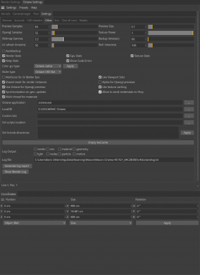

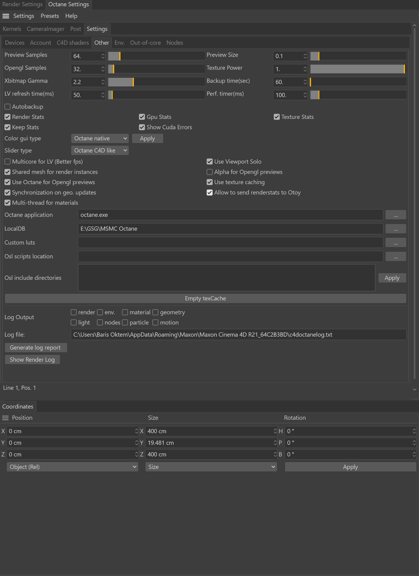

show us all parameters from Settings/others section
barokt
Posts: 27
Joined: Tue Jul 09, 2013 6:31 am
There you go.
Thank you, are you in Turkey right now? :)
