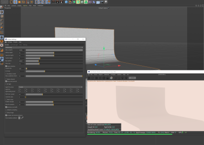

I've been pulling my hair out all morning and I cannot for the life of me figure this out.
For some reason, octane gives me a weird pink tint to everything. If I create a new .c4d project and load up octane, all the lights are normal / grey / default, but for some reason it is pink in my current file. I do not want to copy all the objects in to a new .c4d file becasue whenever I do that, all the textures goes weird and re-positions wrong. The pink background tints everything in my scene, even if I have lights.

Have you checked camera imager for the response parameter? It's not pink if you use default values.
It is set to sRGB. It's also set to sRGB if I create a new project, but in that one everything is grey and normal - not pink.

... and you've got your White Point in Camera Imager set to light blue. Set it back to white, and you should be good to go.
Thank you frankmci!
